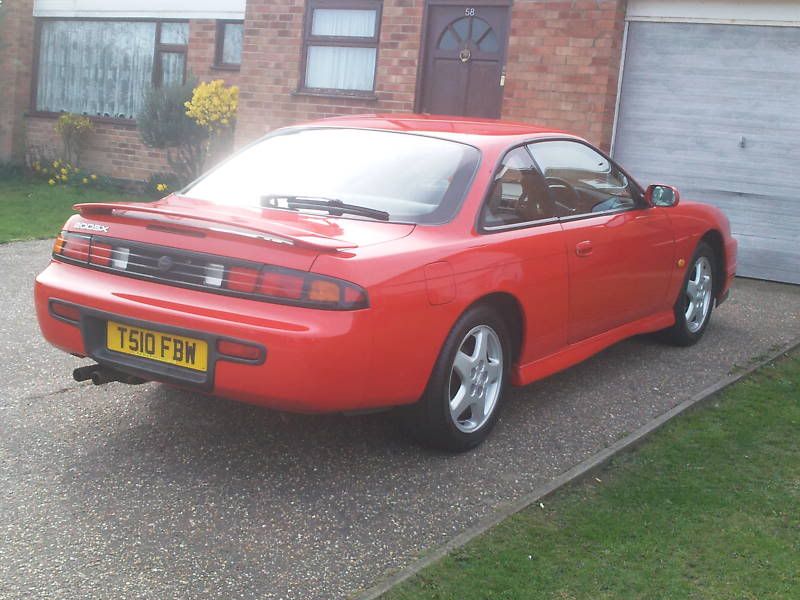

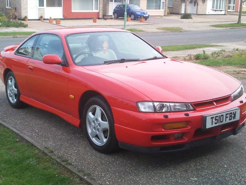

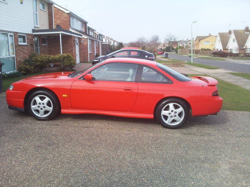

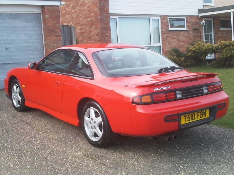

Sorry for delay, pics as requested, got a set of lowering springs chucked in with the car, now trying to choses a set of alloys for it, but need to get the niggles sorted first.

R33 GTR wheels always suit these Shane, might be worth having a look on the Skyline forums to see if anyone is ditching a set.
a nice looking example *wink*

I was initially looking at fitting 17s (as I have a set of 225 55 17s in the garage) but after offering them up I dont think they will fill the arches, I then started looking at the 6 spoke 350z 18s, but the o/s brake calliper seems to have thrown a shit fit this eve so wheels may have to take the back burner at least till the Bm has gone.
Yes its a tidy one, had a friend who works for a nissan deaker cast his eye over it prior to purcase, he said its oneof the cleanest hes seen for a while. Needless to say im chuffed to bits with it.

Don't do it mate, stick to 17's! The ride and handling is so much better, I got hold of some 17*9.5" Split rims and they made the car...
Thats with a small drop via some Tein Springs to mind..

That looks sweet as!!! So far these are my possibles.
Ebay, 140439997071, 110575275961, 190433425000. 17 x 7 is looking favorite as I know the 225 tyres I have will fit without being streched, after having a 205 trye popping off a 7" rim in the past im not keen on the idea, but I have fallen for the 18s, but will probably sway away on keanes advice. On a plus side ive freed the calliper off!!

run staggered? a friends old 200 had 9x18 on the rear and 8x17s on the front
