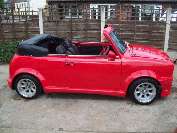

Hi people.... had a few issues with the turbo over the summer (if thats what it was)
After a short 150+ mile drive (our lass Driving) it seems that the thermostat had stuck shut when the car was put back in the garage... i took the car for a quick spin and as you can imagine the temp gauge needle went through the roof very quickly.... i shut the car down as it was losing power and then realised why
After 20 mins at the side of the road and a few litres of warm water the needle dropped to half way, turned the car over but would not start.... we managed to bump the car off and nurse it the last mile home with the temp rising again
I have removed the head and found no cracks or anything noticable and fitted a new head gasket, the car will still not start, i have compression tested the engine and it is giving around 60psi per chamber, so im guessing it is going to need the head skiming
I could do with some slight help to find out the best or most reliable places to take it around the Leeds Area
Any help would be much appreciated (and save our lass chewing my balls anymore about it)
Sorry for the full Essay
and a picture underneath of while it was running aswell
