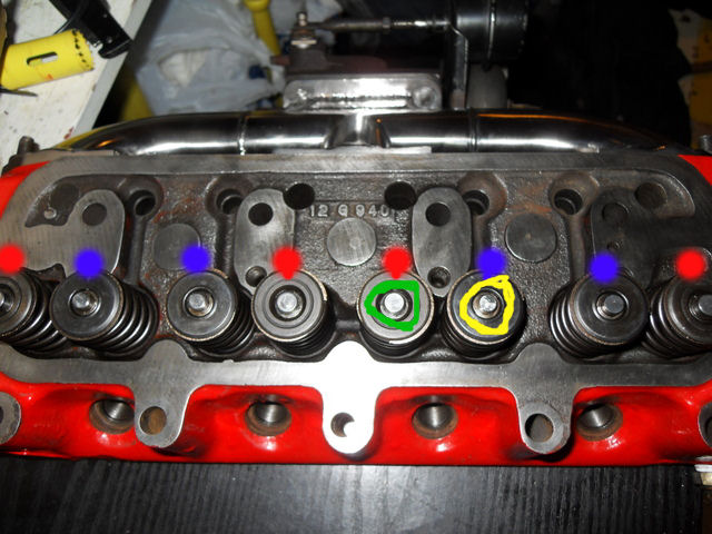

If you get a decent picture of the valve stems you may be able to tell, mine has metro turbo valves and it looks like this:

12g940 is just the large bore casting
4642 Posts
Just look at the top of the valve stems if it has the larger 8mm stemmed Turbo exhaust valves you'll be able to tell just by looking as they're obviously larger than the inlet valves.
Not that it really matters anyway as a NA head can be used. 12g940 is just the casting number & does not define a Turbo head.

the inlet valves are marked with blue the exhaust valves are marked with red,
the green circle is around an exhaust valve stem and yellow circles is around an inlet valve stem
you can see in this pic the exhaust valve is alot thicker you can tell just by looking its quite a difference

thank a million.... now i finally know what to look for.. your a star*wink*
