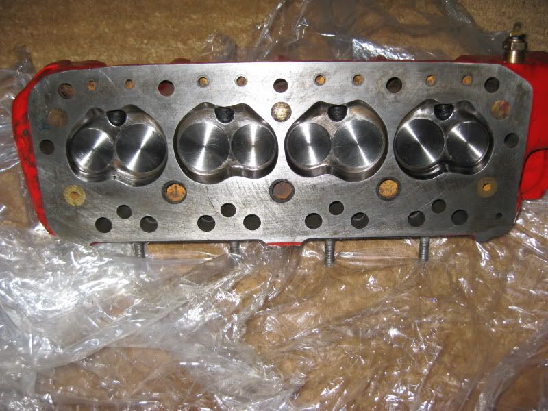

Some of you may know that I have been thinking about buying some kit off a mate of mine. These are a Med 1380 head and a Med Straight Cut gearbox. I have emailed Med to find out the actual spec of the parts but I have been told that the final drive is 3.9 and not 3.1. I have put some emails at the bottom.

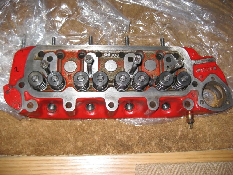

Just been told by MED that the head was a ‘V’ wedge large port rally head with 35.7 x 31.0 valves. Not sure about the box so when I have time, I will strip it down and have a look at everything.

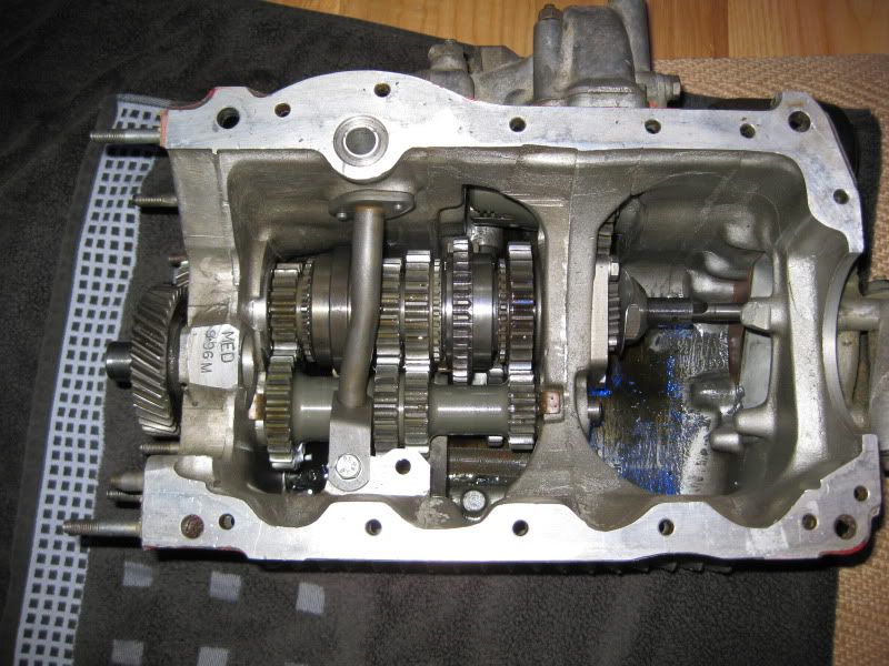

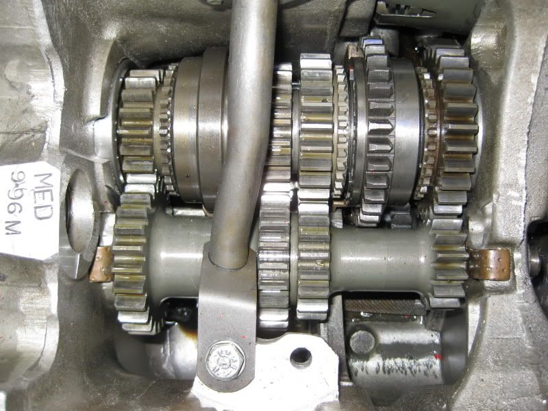

Just found out a rough spec of the box.
It's a straight cut, close ratio, Quaife ATB and straight cut crown wheel & pinion.

the head looks good, the box should be good
