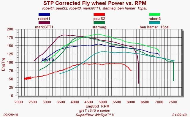

I'm trying to get a flat torque curve on the next version of the 998Ti. If possible all the way up to 7500rpm.
This curve shows typical 1275 turbo torque characteristics:
(Thanks to legrandfromage for this)
What do we think is causing the torque to drop off so quick? I believe that they are all cammed for peak torque at higher revs.

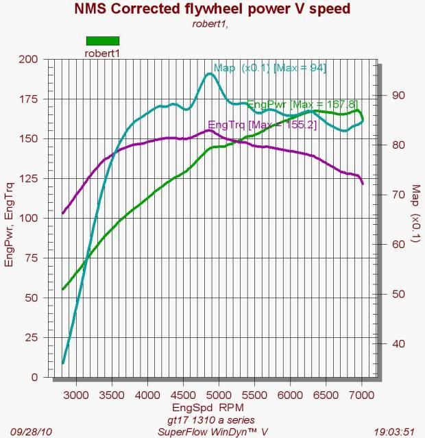

poor boost control paul in mine..
have a look at my curve on 12 psi 167 bhp...the boost was much more stable.
pop up the boost curves as well ..in fact the sot rating is a better rep of the real curve eff wise..
Here is the corresponding boost curve:
I can see what you mean.
This is my torque curve. Despite being lower, it's pretty flat until the rev limiter comes in.
and the associated boost curve:
Curves courtesy of Robert.

heres my 12 psi run ,see how the torque curve follows the boost a bit ..
the torque drop off on engines where the boost stayed level , can be due to a multitude of factors .

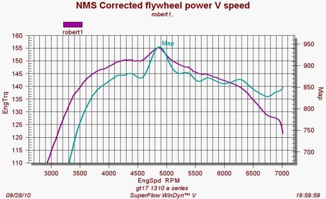

i think the trq graph is a bit misleading ,ill make a zero scale one ..
here we go ..
