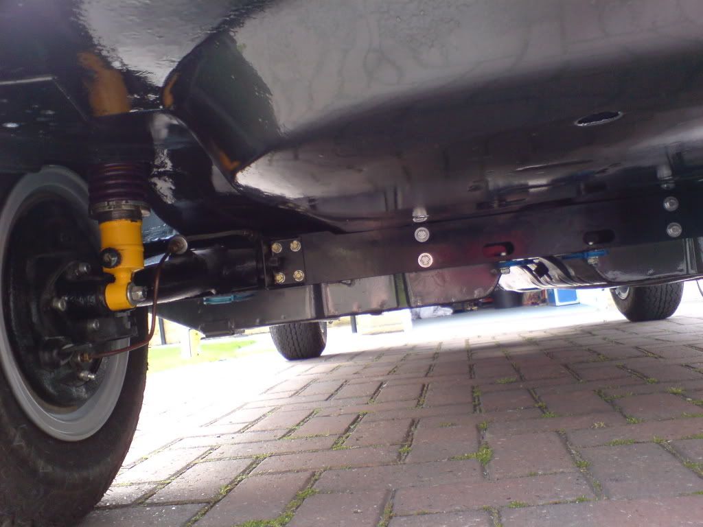

Ive had one for about 4 years and had no problems with it. I don't no if you no but the box section has great big blocks of ally to stop crushing of the box section and helps stop any deforming.
I did however have to trim a small amount from the top (where the bottom of the rear seat panel sits) to make it fit
Hope this helps

As Chris mentioned above. I had to mod mine in the same way to get it to fit. Its as if Minispares screwed up their measurements.
But it fits and it works. I also double skinned the heal board for the additional bolting points.
I'd make my own next time or get one of FastCarl.

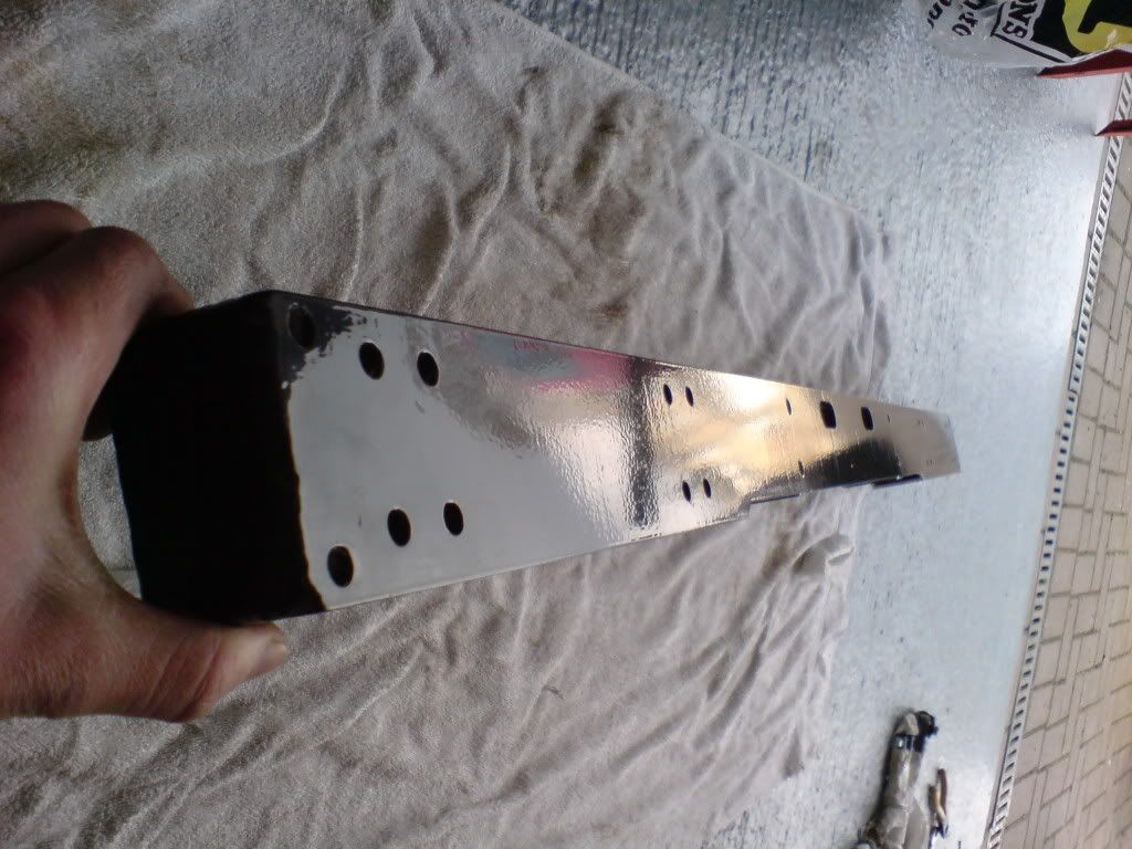

Make one.
bit of cds tube, some brackets from advantage998 = strong and lightweight rear beam for penuts

Thanks for the pictures and advice guys, im in the process of designing my own beam, aluminum is a consideration.
What are the issues people have with the Huddersfield beam?, obviously the inner mounting brackets are shit.
