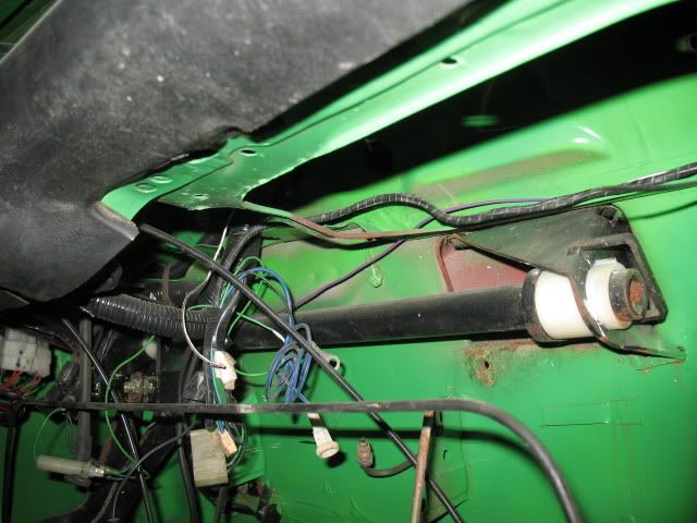

found an image of one, and I see what you mean. Hopefully it will fit behind my heater unit. This particular man is from china who creates these himself for sale for about $100.
if anyone else has information on where to purchase a bar like that give me a shout.

should be easy to find in europe, and quite cheap, at least here in Germany.
and its not only the bar, the pedal box is differend, too, as the bar is welded to the brake pedal.
and you will have to lower the back of the heater to fit
