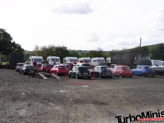

OMG Robert that's a big one

cheers for that guys. just ashamed after bringing down the average yesterday. rather annoying.
Ah which car was you?
quinton
338 Posts
Member #: 1911
circled one
Ah,
black N/A one with a 286 in it?
quinton
338 Posts
Member #: 1911
yea with a crappy 89 banana's at 3900 rpm :(
A lot of people would be proud of that.
thats low rpm!
