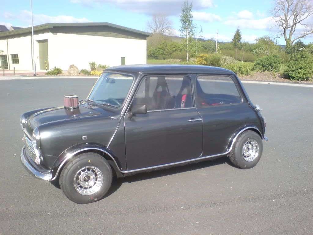

That looks amazing si.

Just pm si, hes running carls wheels as pic just check exactly what set up hes running

I think (Think) that its down to the caliper clearing the inner lip on the wheels, the ones I have seen have a stepped inner section. The TFM thread shows they wont clear the fiesta brakes, but they catch the caliper not the disc

i run as set of 6x10 exacton force racing splits with a032r tyres. brakes are 7.9" vented discs with minisport 4 pots and mine clear. there is only a small gap, but they clear.
