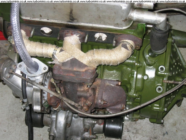

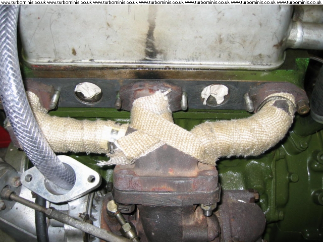

I'm puzzled why noone uses this. If you look at the exhaust manifold of the turbo, its 2,3mm (Approx :) ) from the inlet. This means that the exhaust will indeed heat the inlet to a noticeably degree. To wrap the exhaust manifold like I've done, costs no more than £15.
whats with the plastic pipe in the turbo vegard?
My manifold looks identical to that Vegard.

That's not a solution of the same problem. I bet that of all the air that goes through your vents, NO air flows in between the inlet and exhaust. Period. I'm not saying that it doesn't help, I'm just saying that vents are not the solution of the problem.
Jim: It's the pipe to the intercooler :)
Also, I'm thinking of adding a heat shield around the turbo oil feed pipe. But, is the air behind there hotter or cooler than the oil temp??
Edited by Vegard on 25th Apr, 2005.

I've used the thermotec to increase the temperature og the air reaching the turbo as welll. This means faster travelling gases and possibly less lag. It will perhaps not be noticeable, but there will be a diffrence. Venting the bonnet doesn't do this.
Also, more vents= more air resistance. I don't need any more of that either.
I will however be fitting a ERA vent in the near future, but that does not increase air resistance.
