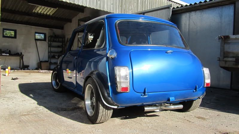

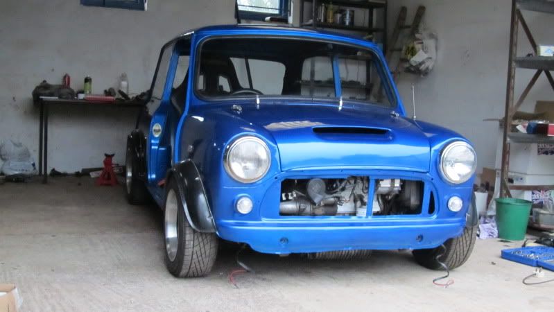

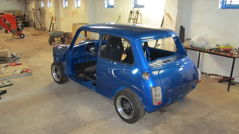

On 27th Oct, 2010 t@z said:
spec, turbo, runs on horse poo, interior pics.....any form of writing?
just being lazy have a project thread on theminiforum
http://www.theminiforum.co.uk/forums/index...howtopic=158889
spec
engine
stage three ported and pollished minispeed head
double spring valves
standard carb with modified needle and K and N filter
stage 1 exhaust manifold with stainless downpipe and silencer
electronic ignition module
45.9bhp a the flywheel (before stage three head)
suspension
spax adjustable dampers
minisport high-low kit
polly bushes all round
12x6 ultralights (with group 2 wide arches)
interior
bare minimum for the moment untill it gets back from the MOT garage, then plans are
no dash rails
custom dash board with integrated centre console
black carpet
black door cards
chrome handles sports steering wheel
tachometer mounted on steering column (nice big halfords one)
cobra monaco bucket seats
racing 3p point harnesses
future plans
rebuild 998 a+ engine with t3 turbo spec is still being decided
will post some interior pics when i get a chance
hope this is more helpfull

On 27th Oct, 2010 Advantage said:
T3 and 998 is not the best match I have red.
T2 is more appropriate I believe.
If you already have a T3, maybe you can trade it somehow ?
yea have thought about this recently i think ill be going or a bigger bore route 1293 most likely then the t3 will be more suited
