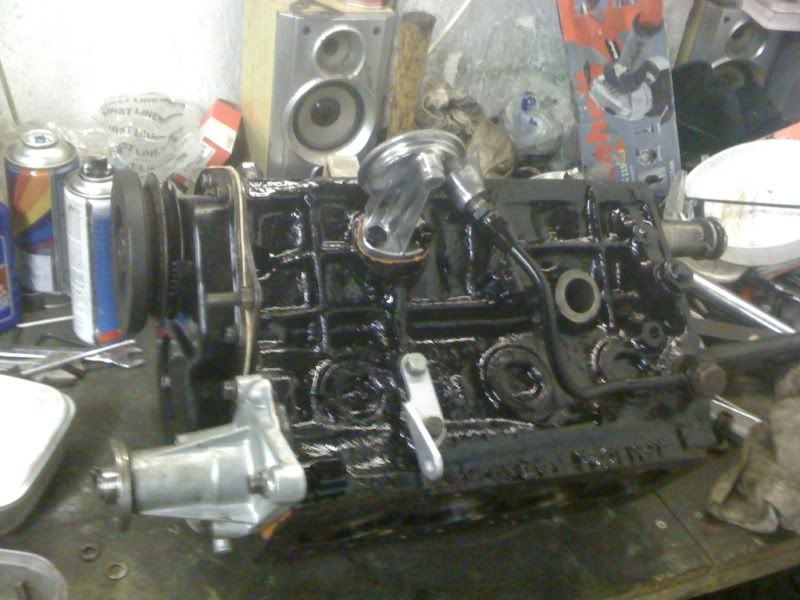

Been building my 1380 engine which I will run N/A for a while, and got used to and fitted the megajolt.
Then will source a new head, get some 28cc chambers in it, and fit all my metro turbo parts.
Sorry about crap phone pics, I hope to have it running in the next few days.

Rebuilt.
Cleaning everything, and polishing all gasket faces is taking ages. Hopefully it'll pay off and i won't have any oil leaks.

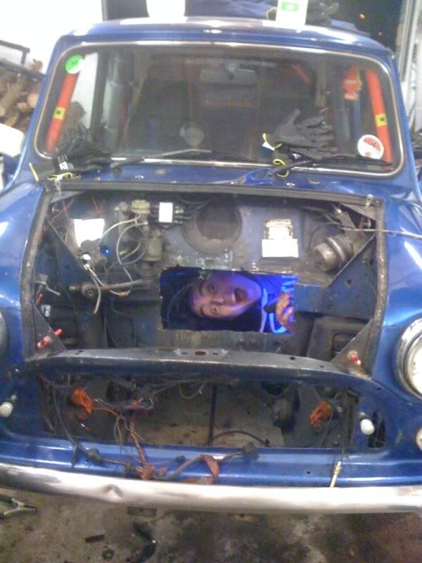

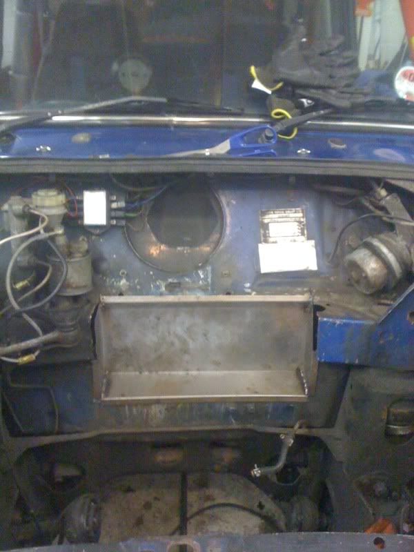

998 out
Nice big hole, and me being a twat.
Didn't get a pic of it all welded and the bulkhead fold for the actuator, quite happy with the outcome to be honest.
Tomorrow, a bit of paint on the bulkhead, 1380 motor in.
I've got a cross pin diff and straight cut drops on their way to me from a couple of members off here.
And my crank pulley should be back from the machine shop soon, so I can fit my megajolt in the next coming weeks.
Nearly there now.

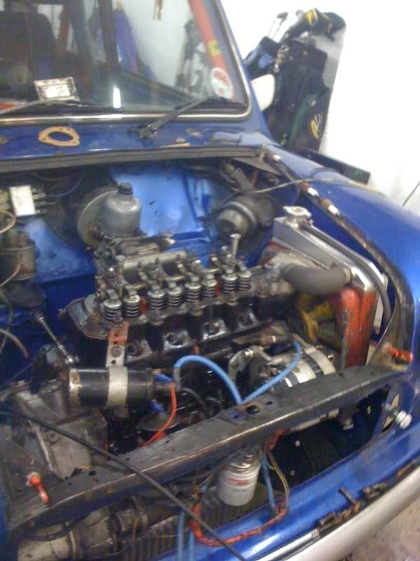

mini_mad69
257 Posts
Member #: 7048
Bridgend
Got it going today, well once I got the dizzy the right way around *oh well*
It's got a bad knocking noise up top somewhere though, it runs great, with fantastic oil preasure etc.
I think the rocker shaft/rockers might have shit themselves, so will give it a go at changing that and fit a better carb.
Turbo parts collector at the moment, almost ready.
Check that a rocker isn't hitting the cover.
mini_mad69
257 Posts
Member #: 7048
Bridgend
Did that, I was hoping it was that simple. No marks on the inside, and I tried 2 different covers. I've got a rocker assembly with me so I will give that a go.
