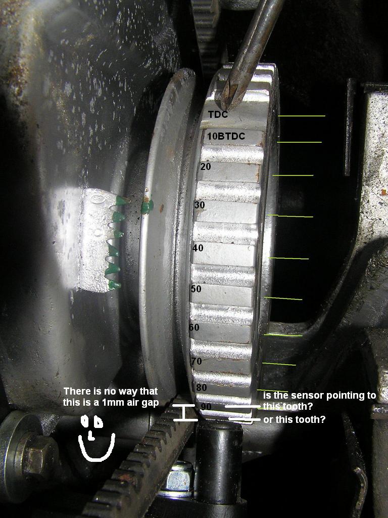

Each plug on the coil pack is numbered 1-4. No 1 plug is by the water pump. Running right to left, number 4 is by the flywheel.
The missing tooth should be picked up 90 degrees before top dead centre.
This picture show's it quite well.
Ignore the bit about 100 degrees as that was part of a discusion on the sensor position for out van.

It's the missing tooth that is important, all the rest are just 10 degree timing check signals for the processor but the trigger (the missing tooth) must be sensed 90 degrees before TDC for the processor to have time to calculate the spark degrees.
TMake sure it's 90 degrees before top dead as that is what MJ/EDIS is expecting.
I'll have a look at my pulley etc from Ben tonight if you get stuck

i would assume bens kit can go only 2 ways? 90 degrees or 180 degrease
i have the later kit that is laser cut & mounts from the radiator bolts.
but same trigger wheel
http://img.photobucket.com/albums/v668/ben92/P1010251.jpg
Edited by NickG on 3rd Nov, 2010.
that's the same as mine. I think mine was the prototype

I bets its the plug leads. If you have attached the wheel as per the pic you posted above its correct.
Thanks was the pic Ben first sent me when I had the first kit he made :)
