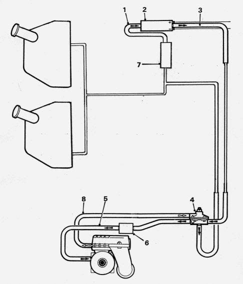

great that sounds like fun!!!! also just found ou that i have to plumb in a fuel return line to the tank now i know there is a few options. weld up the standard tank, buy a mpi tank (????!!) or put in a t piece. i like sound of the last option, hows this done? SELL MY MINI?!, Id rather dip my balls in battery acid. |
![]() 928 Posts Member #: 326 Post Whore bradford, west yorks |
1st Mar, 2005 at 08:27:53pm
hey liam, i am also doing the T-peice option as its a lot cheeper and proven to work,
