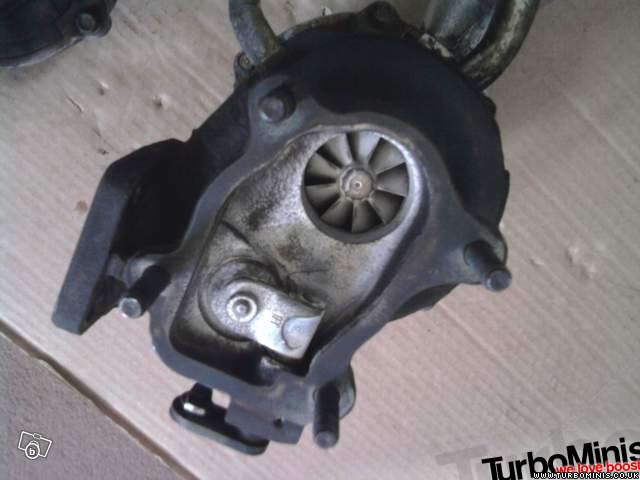

I wonder if there is any potential issue to keep on using a turbo which exhaust housing is cracked.
The crack starts on the waste gate seat.
Can the crack be stopped by drilling a small hole a the end of it ?
Rusty by nature
Lots are like this and don't usually cause a problem.
stevieturbo
3597 Posts
Member #: 655
Northern Ireland
Wouldnt worry about it. Would be more concerned as to why its white in there ! lol
9.85 @ 145mph
202mph standing mile
It is quite common. In extreme casess it can lomit maximum boost owing to leakage.
Yes as has been said. all the above and also some people say it can make a little more lag. Due to leaking, but that's it.

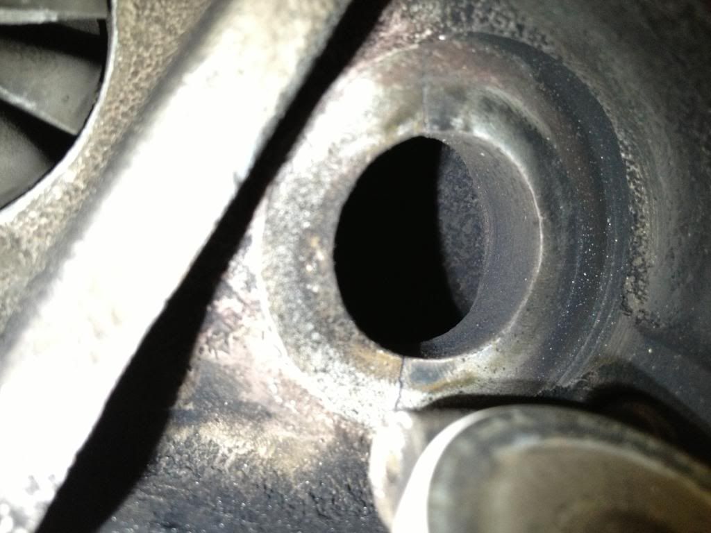

hey guys, ive had a look on various threads about cracked turbos but they all only have 1 crack, mine has 2 cracks both pertruding from the wastegate, but theyre quite big, would you replace the housing? or leave it.
http://i185.photobucket.com/albums/x28/joh...pg?t=1366536790
one of them isnt too bad, but the other is quite large and continues past the wastegate opening (looking into the turbo from flange) by about 15mm
Some pics john? , if they are bad a large. Chunk may break off making the Turbo useless

i have the one pic in my post, i will get some more of the inside of it today
