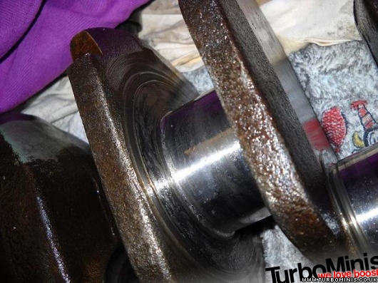

14th Nov, 2010 at 07:44:22pm
This is what i found when i went searching for my little problem Edited by paneermeel on 14th Nov, 2010. there is nothing wrong with a A-series that a turbo can't fix.

![]() 1183 Posts Member #: 6926 Post Whore Accrington |
14th Nov, 2010 at 09:09:20pm
wow
14th Nov, 2010 at 09:19:35pm
LMFAO, Wet 'N' Dry On 26th Oct, 2004 TurboDave16v said:

how many miles had the engine done? 2 meter:) It was the first drive since the rebuild.
Now i can hit myself, the engine dropped in revs but i tried the clutch one more time and then i heard a noise that said: This is going to cost you some more money. Looking at the damage on the crank and thrust i'm starting to believe they were put in the wrong way. Not by me, but i should have checked it, dammmm. A hard lesson. there is nothing wrong with a A-series that a turbo can't fix.

What was the crankshaft endfloat when built? On 13th Jul, 2012 Ben H said:

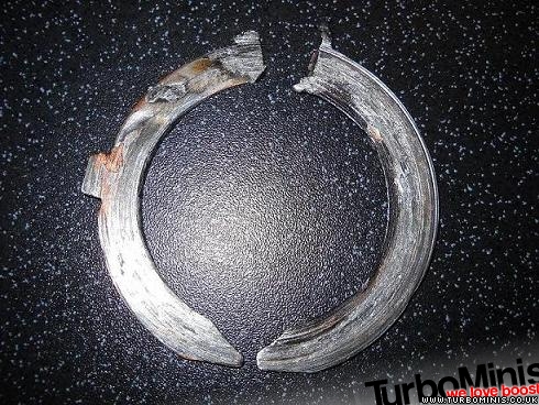

16th Nov, 2010 at 06:11:18pm
The other side has some copper left but the most of it has gone.

16th Nov, 2010 at 06:46:04pm
the back does not have any copper on it to start with. I assume the thrusts have spun especially if you found one half in the sump? On 26th Oct, 2004 TurboDave16v said:

On 16th Nov, 2010 Sprocket said:
the back does not have any copper on it to start with. I assume the thrusts have spun especially if you found one half in the sump? The parts were still in place but the part that is missing lies in the sump, in pieces. And one side of the trust is completely broken (see photo) the other side is the side with the grooves. The grooves are now filled with material. When i removed the bearing cap the trust fell out so am not sure how it was mounted. But one side of the trust is worn en so is the crank. This would mean that the trust were mounted the wrong way. And what Vegard says with to much endfloat:$ there is nothing wrong with a A-series that a turbo can't fix.
