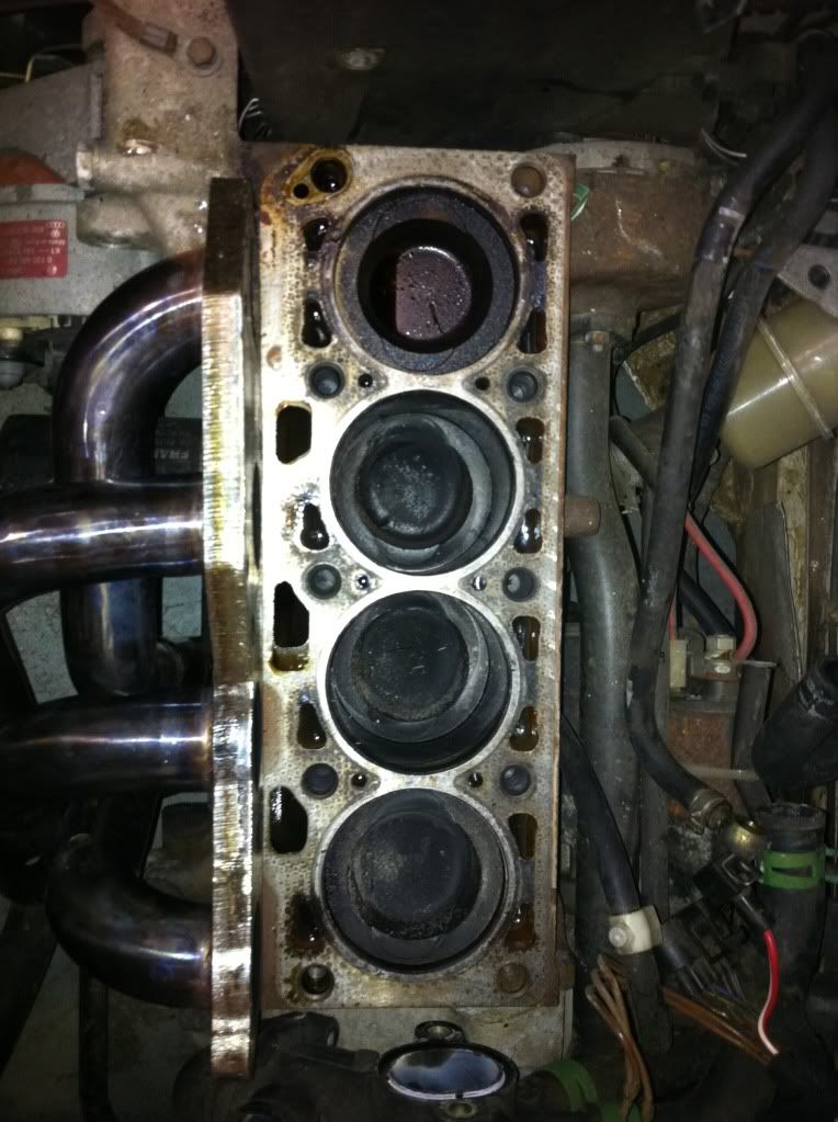

well all stripped and changed over now, running fine again.
it had a lot of oil/water mixture in no1 piston:

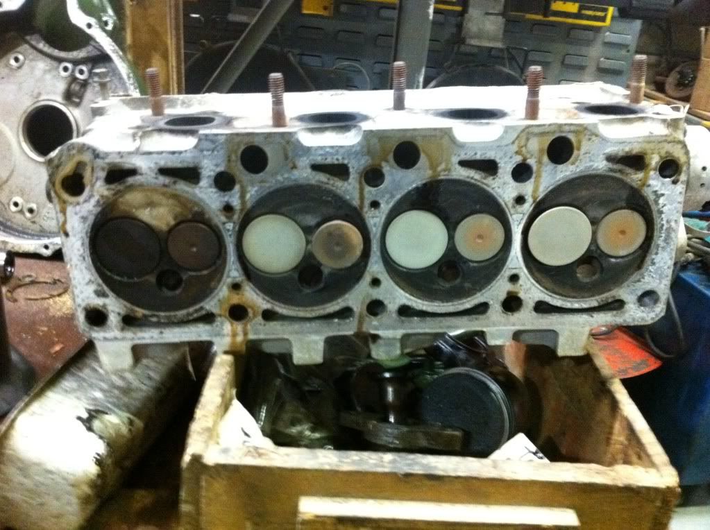

and the head looked like this before i cleaned it:
luckily the head had no distortion or warpage what so ever, i used a accurate skimmed staight edge and a feeler guage, couldnt even get the 1.5 thou feeler under the straight edje and no light to be seen whatsoever, luckily it all cleaned up very well.

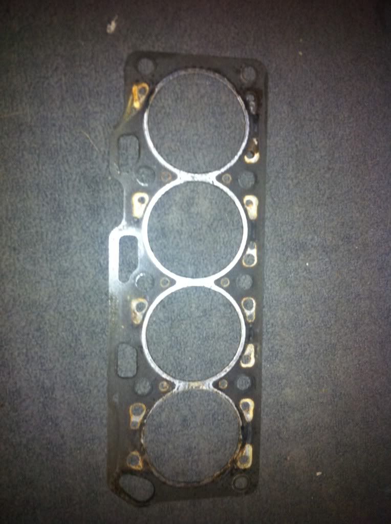

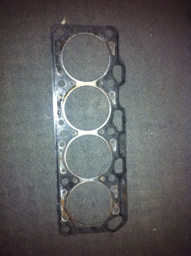

heres the gasket:
looks as if the gasket has just failed due to being 20 years old, i think the desighn of it didnt help as if you look closely the waterways are tragle shaped and quite large wheras the gasket had small circular holes with couldnt have helped anything and in my mind makes me wonder if this is why it failed prematurly, the new gasket was different and actually sported the right cutouts.
