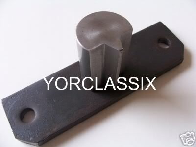

something like this,

I have the one pictured above and it has served well, certainly not had any issues with it, other than the initial cost.
I have seen another that was just a piece of angle iron welded to a flat plate. At first I considered it to be shite, and I still stand by that, but since it bolted to the wok side of the starter apperature, I have now realised the theory used, that if you are changing the clutch with the engine in the car, you don't have to remove the starter *happy* while the fancy one pictured above needs the starter removing but not the wok, which is much better if you are working on the front end of the engine. Dropping a bearing shell into the clutch housing will only create hours more work.

Where's the best place to get a Austin ring gear style tool from ? The one in the photo only locks one tooth eek
