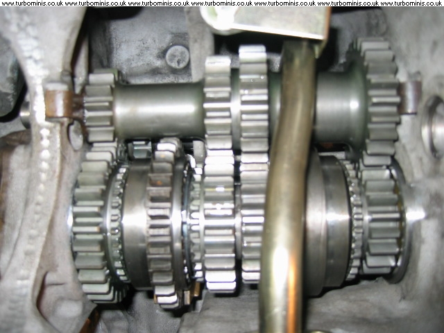

Mine:

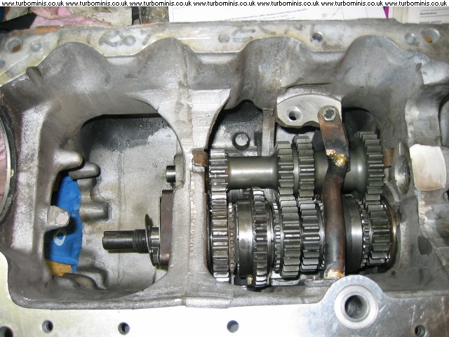

A friend of mine's:

In the top pic I see you have increased the engine to gearbox stud/bolt size is this worth doing
Some people say it is, some say it isn't. I did it anyway, as it doesn't cost any money :)
vegard you may have forgot? buddy
i noticed the securing stud in the pickup pipe not locked or have you done it another way?
whats the ratios please
Locknut on the rear.
The upper one is Minispares ST set, and the Rod-one is the Clubman set.
Can't remember the ratios off hand.
2,54 first??

why the remote gearbox are they better than the rod change box. I am planning on buliding a box for a grasstrack car what would you recomend.
6297 Posts
they look a bit better than mine.. LOL
I like rod boxes more, because have fewer things in them. That means less items to wear etc. Apart from this, the internals are the same, so that doesn't matter.
Also, the A+ boxes has got some bigger shafts here and there, but the material is downgraded. I've always found A+ boxes more worn than A ones. Also, the ratios are crap, so I really don't like A+ boxes at all.
The remote one is for my historic racer. Rod ones not allowed!
