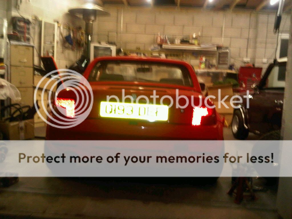

Hi all. I've been building and tweaking this mongrel of a mini during the last 7 years.
And having moved house with a bigger garage I had an urgent need to fill the other half of the garage with car before the wife filled it up with tents, bikes and other crap.
It had to be a proper Mk1 this time but I came home with this lol.
It came with two sets of decent alloys, these are 13 x 8 and are illegal I think as they poke out too far which is a shame as i like the look.
Sorry about the crap pictures.
So the bad bits: Nothing electric works, horrible damp interior, no brakes, no mot, needs an exhaust, everything that can move is loose, scabby subframes, worn bushes.
Good bits: Monocoque is sound and the paints good. Came with two sets alloys, all good tyres. The engine is 1293cc, 276 cam, modded head....nothing special.
Plans: This isn't gonna be a full on restoration. I want to drive it then do a bit. What's nice is it that there is no welding to do and the paint just needs T cutting as it is presentable.
It's basically sound it just needs fettling so I'm gonna... Rewire the electrics, make a new dash and sort the interior;
Fabricate an exhaust system as all I've got is a cherry bomb at the moment and its too loud;
Refurb both subbies which are a bit scabby.
I'll rebuild the engine last, Turbo if I can afford it.
Well the interior is dire as you can see:
So i'll get cracking then....

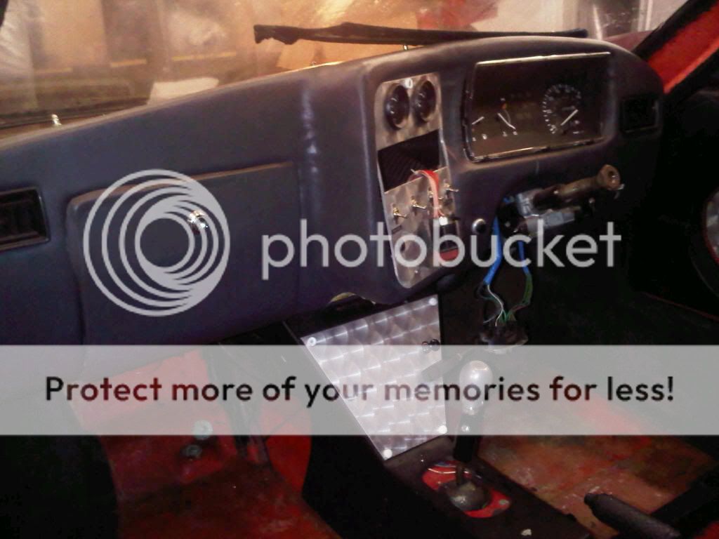

So...repaired the original GTM dashboard and it still looked crap and also required the windscreen to be removed every time the dash needed to come out.
I fancied a Miglia/race style dash, real simple, no clutter with modern instruments.
Made this from fibreglass for £50
The smiths temp guage is just filling the hole til I get a boost guage and the narrowband will do until I get another wideband.
Next up.... Steering column cowling. I don't think my mini ones will fit and they're horrible rattly creaky cheap things anyhow.
Thinking of using a wide cider bottle or similar as a mould and making one from fibre glass....

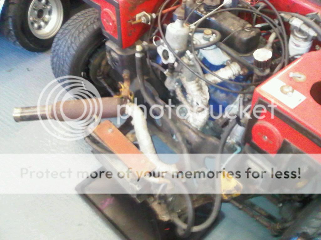

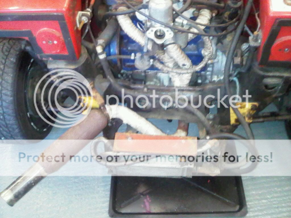

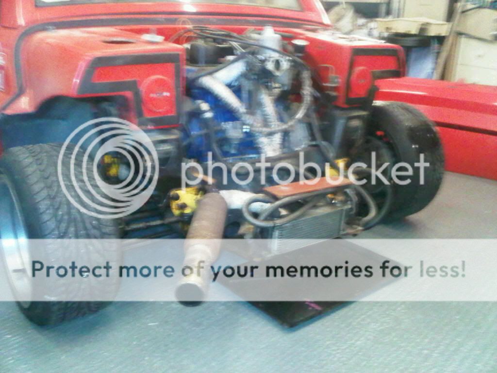

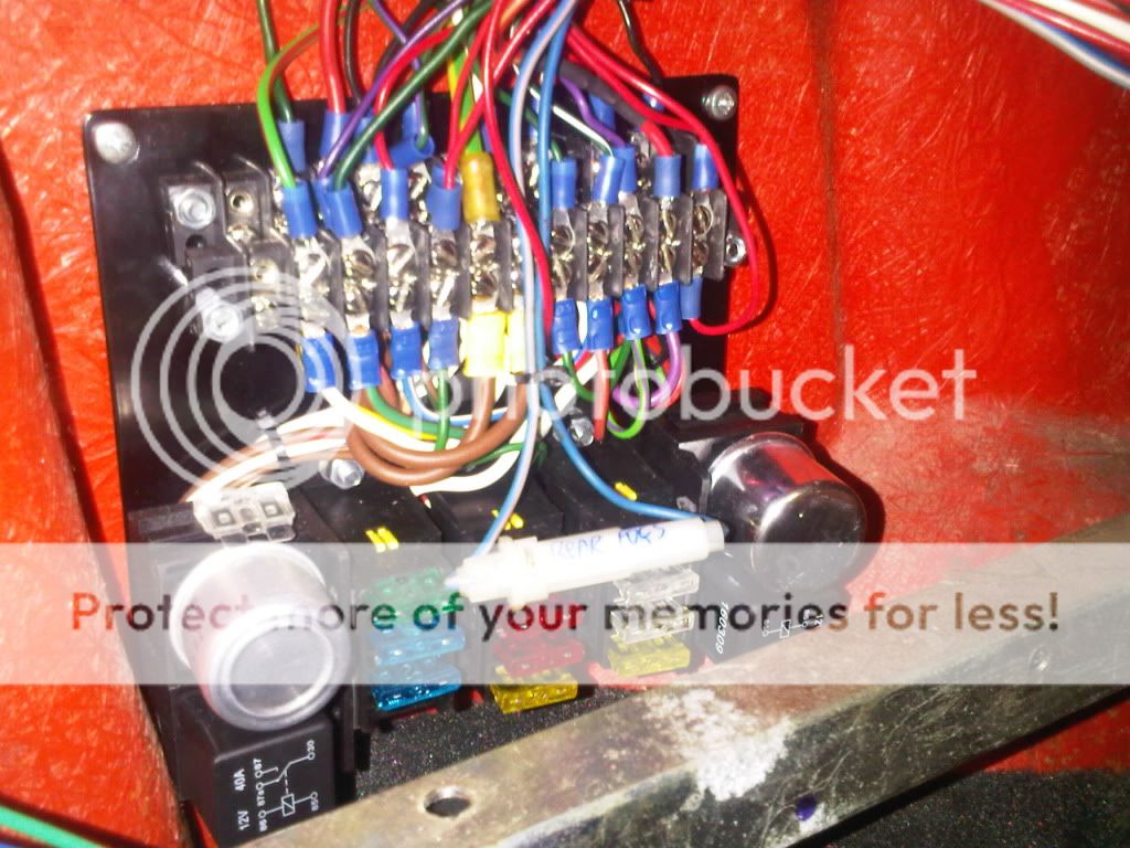

The wiring was a bag of nails
Rewired everything
Turned my attention to the exhaust for the time being as it sounds like a tank.... You can see why lol. I've ordered a stainless RC40 back box and some other bits and pices of tube to make a custom exhaust. I only have the space available that the old exhaust took up so it wont be too easy to fit in. The exhaust manifold is a maniflow cooper freeflow. It will be easier to keep that than fit an LCB.
When I have all the individual pieces of my exhaust ready for assembly would it be better to just clamp it all together rather than weld each piece? I ask this because any previous exhaust failures I have had have been cracks right next to the welds.
One good thing for the future, there is a lot of space for a turbo*smiley*
