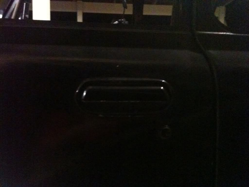

And is it this style you want?
In boost we trust
That's the style!
I guess we'd need a good sized chunk of door and all the rods etc that are different to ordinary doors.
Are the locks seperate?

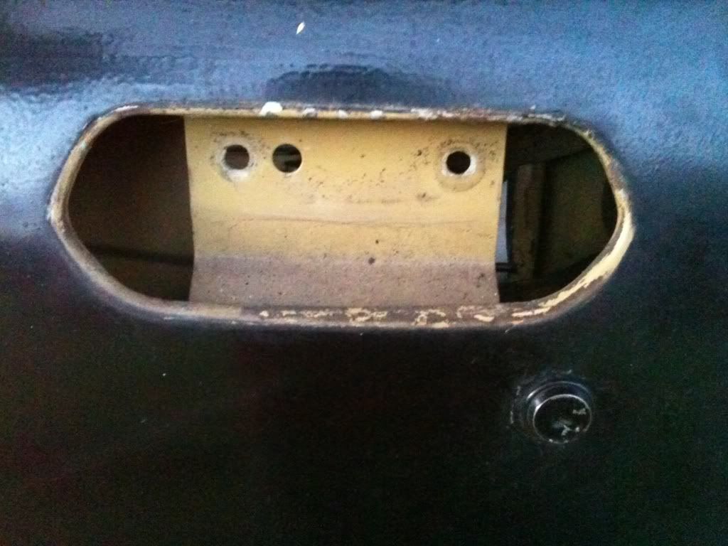

Right i took the passenger side apart quickly today. Got it nearly apart but the lock is still in the door.
The slam plate
Internal mechanism

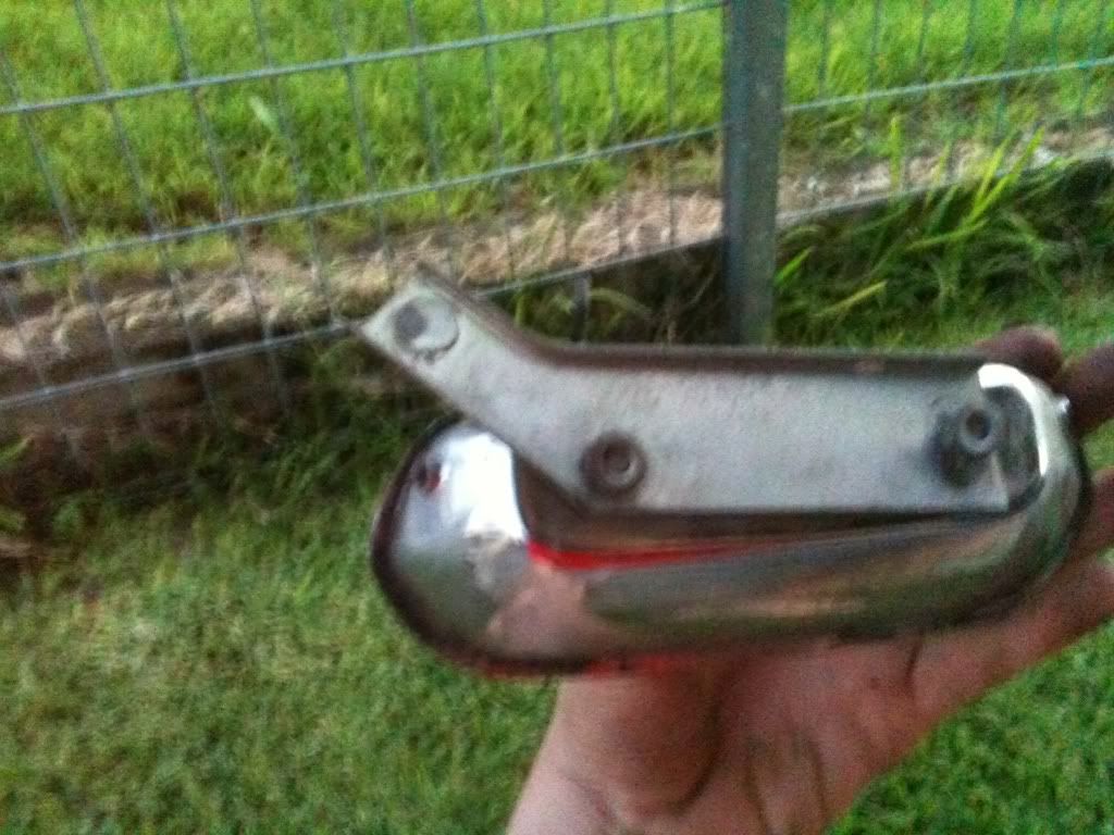

Back view of the lift up handle (that bracket sits behind the door skin and holds a plastic rocker that joins the handle and the lock mechanism.

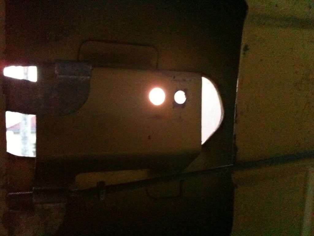

Internal view of the mechanism. The whitish bit is half of the plastic rocker.
Front view of where the bracket bolts in and holds the handle in place.

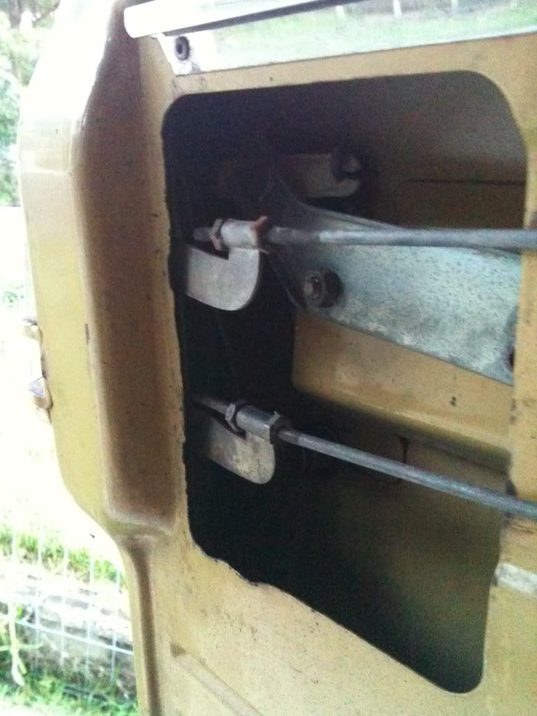

The inside view with the 2 rods coming through from the door handle. Looks like you just need to cut the right sized hole in your door then bend a bit of sheet to mount it on and youd be sweet.

Looking at that, I think I would need the whole door. Thanks for taking the pic's.

I would have thought the rover mechanism would work fine with those handles?
i have some rover mechanism parts laying around ill look some time.
Edited by NickG on 15th Jan, 2011.
Actually you're probably right. With the plastic rocker bit and the bards either end it may. Would still need the locks and a section of door to use as a template...
