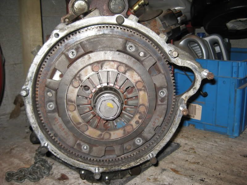

Here is a photo of it. I think that I do need that puller as I can see three threadded holes for it to fit into.
Yet another tool to buy *frown*
Speed doesn't kill, suddenly becoming stationary, now that's what'll get ya!
that's verto.
you need a puller and you need to take the big bolt out of the middle (it's not 33mm, it's imperial *wink*)

Got the middle bolt out (33mm impact socket fits but I know it's a 1 5/16). When using the puller, do you leave the 6 clutch bolts all done up or taken out or loose?
Also, does the flywheel have to be horizontal when pulling it and do you need to lock it (or do you lock it only to remove the centre bolt)?
Thanks guys
best to have the 6 bolts in when you pull it, as with the bolts out when the front bit comes off the rear bit can fall down and twat the crank.
the flywheel can be pulled in any position, and yes you need to lock the flywheel, somthing wedged in the ring gear usually.
you'll need a decent length breaker bar to do the puller up, like 2 ft.
also make sure the puller goes on square, put it on, take up the slack, rotate it and ajust the 3 bolts if needed, also there are two different threads for the puller bolts, one for verto's one for pre verto's, IIRC the vero is the coarser set.
mind your feet, the fly whee'ls can jump off if they are tight!

you have to lock it to do the puller up, you have to do the puller tight.
Turbo_Jonesy
174 Posts
Member #: 9041
If you have a old shell casing put in in the flywheel where the starter motor sits that should lock it up good. You need to lock it up otherwise as you tighten the puller the engine will just turn over...!!
And yes remove the bolt in the middle the part of the puller kit will fit in the space nicely you will see when you get the kit..
