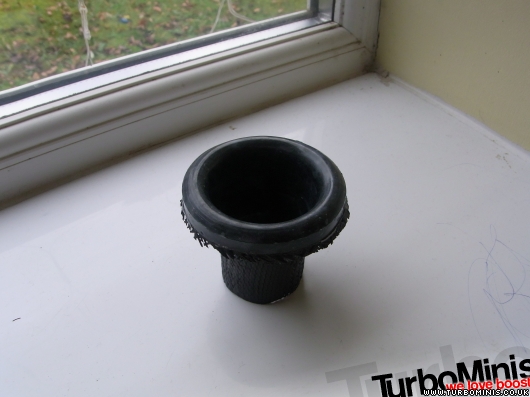

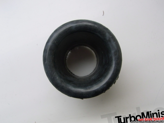

Wet lay up carbon.

looks good. Home made from a big lump of ptfe?
I've been thinking about trying my hand at making a few odds and ends out of fibreglass. How difficult did you find it to make?

fg? piece of piss.. just very messy :)
Have you laid it on original ally trumpets?
Luckily Eric (Clan man) is an expert and has taught me well.
It is pretty easy, but it was much better to watch it being done rather than reading it in a book.
I have the rest of the plenum to make using various techniques and materials.

This one was the result of a master class. I'm half way through the second (they take 2 days to make) which'll be the true test.

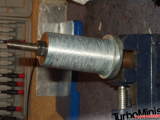

what did you use as a mould for these?
something a bit like this, but a slightly different shape. The photo shows it with a layer of gelcoat on.
