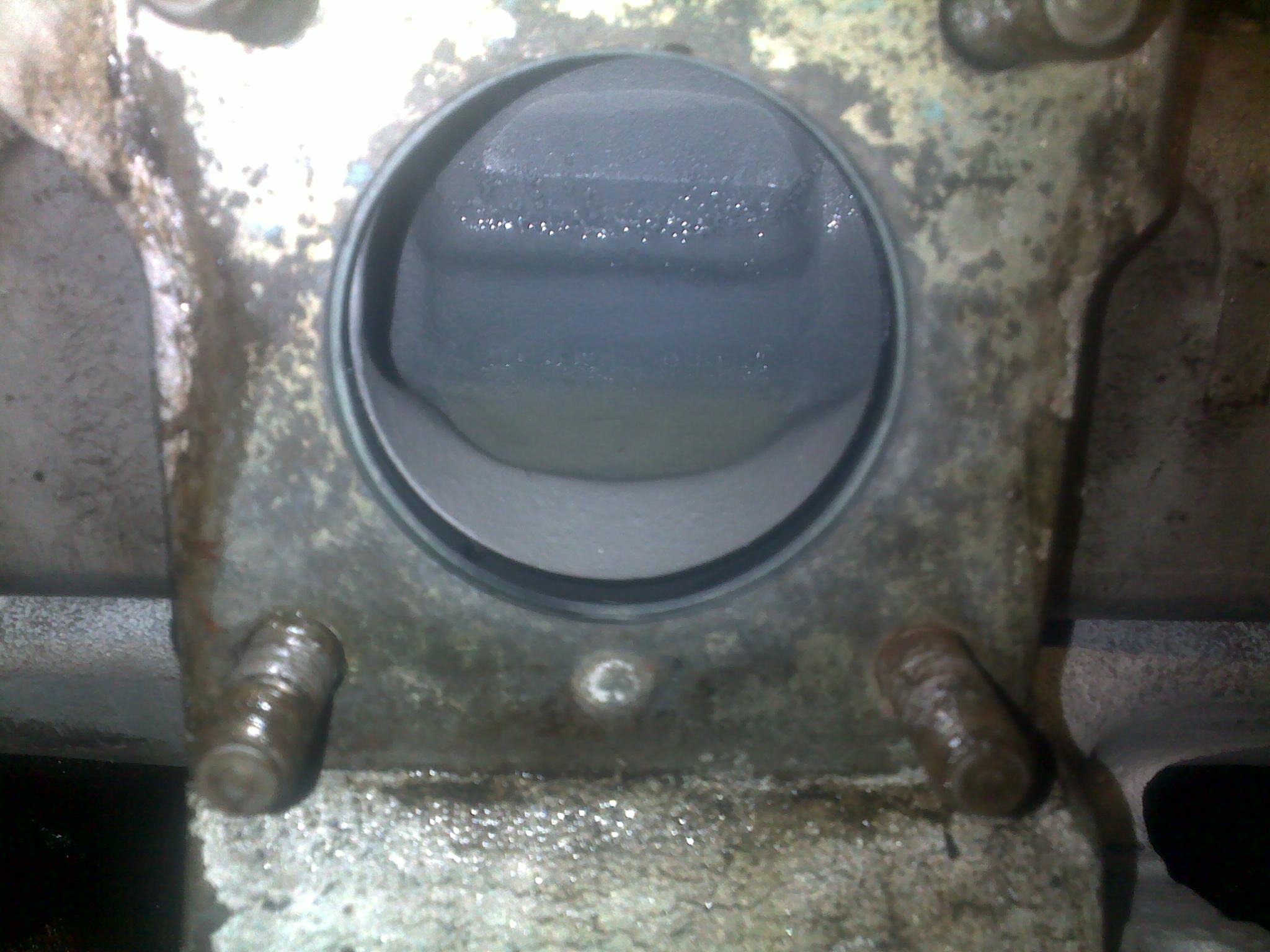

I did try it again with no luck. so i took the dashpot off again only to find loads more fuel. there was a little pool of fuel in the intake (see pic) so i took off the carb, as i was taking it off when i pulled off the blocked up overflow pipe it spewed out fuel (obviously) but so did the plenum pipe too! there was that much fuel. Anyway i dried up all that and emptied the carb took the bottom of the carb off and litterally just took it apart, cleaned with carb/brake cleaner and put back together. now runs as it did before. The spark plugs seem to work fine though, why would fuel soaked plugs be no good?

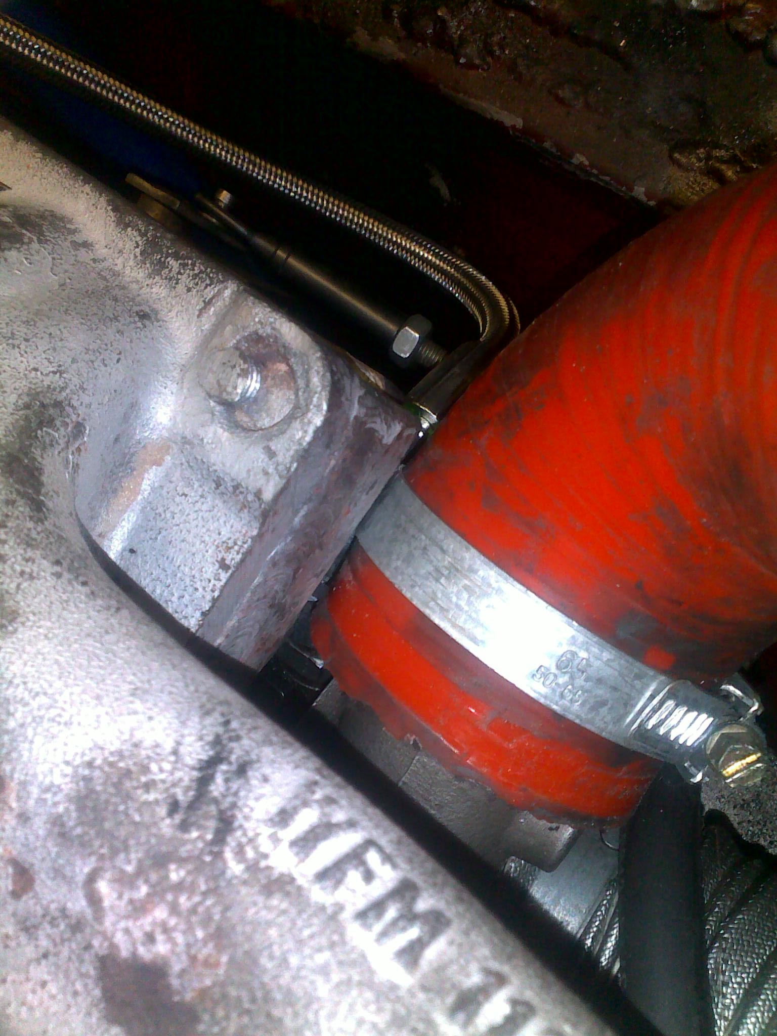

ALSO, will the heat off my exhaust manifold melt my IC pipework (see pic)

Certainly a lot closer than I'd be running a boost pipe to something that will glow absolutely red hot lol

Well i thought that, but the turbo was bought off here, in working condition... which it is, but ive had to modify a lot of things on it to even get it in a state to put onto my mini, anyway ive done the modding and now it seems fine but i still dont like the fact that its that close! specially if i want to run high boost.

Wont matter what boost, it's still going to get bloody hot !!!!
You'd be better with an aluminium elbow or something welded onto the turbo exit to give clearance before anything meltable or burnable

yeah i have a feeling its going to melt. i think its rated at 200c hmmmmm well if it does melt, what is the worst that can happen? besides a bit of smouldering. if it does infact melt and burn a hole the turbo will blow it out and leak air? if this happens i will have to take it all off again and get a piece welded on.
I dont want to sound like im trying to do the bodge solution, ive just been having such a nightmare getting it all to fit and now that its all on i dont want to spend another 4 weeks taking it all off and putting back on. plus the garage i had it in is no longer available :(

just as an extra measure, i put some heat resistant mat around the pipe, hopefully this should help.
