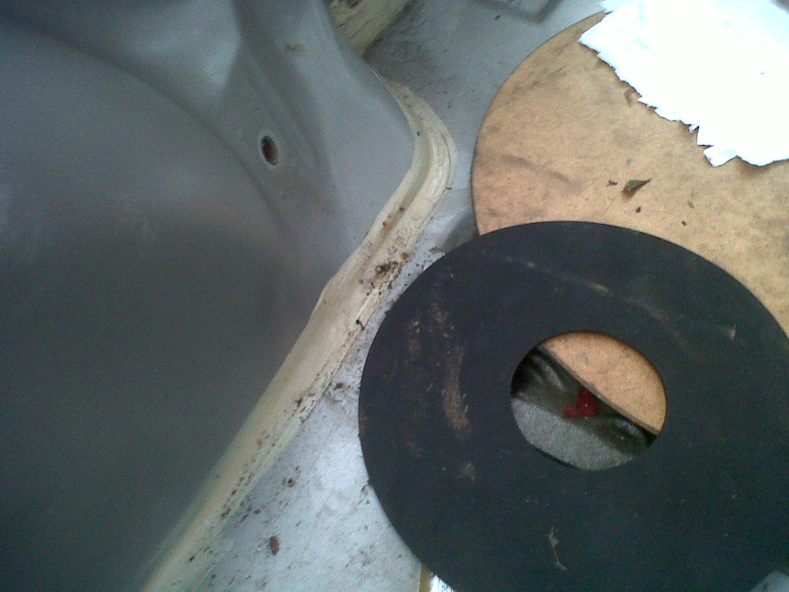

Just stripped the interior to my metro and am wanting to no if the sealant along the edge is normal.

yes its been on all the metros i have worked on, john or mr flanigan aka giallofly is best to ask for the handeling side of things

It is seam sealer, can rust behind it. Solid mounting the subframes improve the handling and making sure there is no play in ball joints, track rock ends etc
