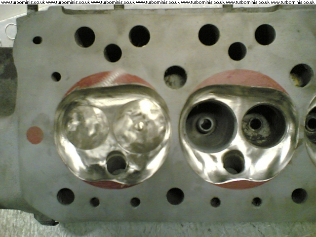

Hi ya, took me just under an hour to make a start on this head let me know what you think
http://turbominis.co.uk/index.php?p=slideshow&id=529
http://turbominis.co.uk/index.php?p=slideshow&id=530

red cross looks good.lol.

lol think that should work

what cc`s you got them out to??
mikemph
450 Posts
Member #: 449
Oxford
thats what i was trying to do
mikemph
450 Posts
Member #: 449
Oxford
I have no idea yet just roughing out the shape. Its just a budget banger. Using the janspeed sort of setup using a VNT 15 turbo good for 200bhp mounted on the clutch housing. Just a little project to use up spares and spare time at work.

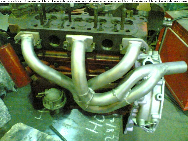

The manifold, cut and shut from maniflow LCB

4641 Posts
Somebody's handy with the welder ! Nice job mate. *smiley*
mikemph
450 Posts
Member #: 449
Oxford
Cheers mate, I didn't think it was bad myself *tongue*

looks good...
it'll be interesting to see how long the turbo lasts for...
keep us posted!
Alex
AlexF
I'm more interested to see how long the manifold lasts!
Seriously, My first manifold to take the T2 was a cut/shut maniflow LCB. It lasted around 2 weeks before the first crack appeared. After that, I started chasing my tail on the new cracks. I'd be inclined to source some really thick steel tubing, or decent grade stainless (302??) and start again!
VNT stuff is pretty interesting though! Fab was trying this some time ago, not sure how far he got mind!
mikemph
450 Posts
Member #: 449
Oxford
Yeah I will do it from 316 stainless when we get some more in at work, don't fancy paying for it at the moment lol. When work get some in stock its free *wink* if you know what I mean.
I have got the use of a mandrel pipe bender so should be nice and easy, and a TIG welder so should be sweet as!!
Just liked the idea of the boost coming on nice and early with still plenty up to top.
Edited by mikemph on 14th Mar, 2005.
4641 Posts
Dave's right about the risk of cracking. My mate has made two sets of manifolds to date. The first one was very similar to the one Dave made up. Mild steel using the flanges from an LCB, he was forever welding it, but managed to get 6months or so before he gave up.
His latest design is mounted over the clutch housing and he's using high quality stainless tubing. Even this has cracked but only slightly in one place. Though this was subjected to some extreme heat, often glowing red, caused by some "interesting" boost levels. *wink*
I would suggest adding some form of bellows to allow the manifold to expand and contract.
Phil. *smiley*
Edited by Turbo Phil on 14th Mar, 2005.
mikemph
450 Posts
Member #: 449
Oxford
Yeah, bellows like the janspeed one had would be good. I am looking for that at the moment. Think I found something that will do in our stores at work.
I think the cracking may have something to do with the heat and the carbon deposites on the inside of the tube, basically hardening the mild steel with the heat and carbon. Just a theory tho
AlexF2003
5795 Posts
Member #: 80
AFRacing LTD
Newbury, Berks
Its more often one of two things:
Support
Expansion
Steel grows a fair amount with temp, and if you don't allow for this in the design it will crack. The support thing is less obvious but a turbo is a heavy lump to support and is subjected to not only vibration but also accelerations in every direction from the movement of the car itself!
alex
AlexF
mikemph
450 Posts
Member #: 449
Oxford
Stainless comes in a highly stressed form already so i guess it keeps its shape better.
I wasnt gonna hang the turbo on the end lol, but i know what you saying buddy.
Mild steel does expand alot more than the likes of stainless
Hedgemonkey
591 Posts
Member #: 360
Stu from Corwall aka Mr Jazz Piano, Love_Machine, kneegrow
Don't get me started about manifolds crackink, had a nightmare with my mates old TVR stainless manifold, we welded it and it cracked somwhere else, etc. Stainless absorbs oxygen when it gets really hot and can set up imperfections which add to the fact it's brittle anyway. Mild steel everytime. I would get it blasted and try some novel ideas about stress relieving. I hate cracking manifolds, everytime you fix one, you should stress relieve it. Honestly, the amount of mucking about I've done with home made exhausts/manifolds is ridiculous.
Bugger off, I'm getting there.
mikemph
450 Posts
Member #: 449
Oxford
Might have to see, might be able to heat in a oven, have to wait and see wot happens. I didn't have any problems with my last stainless manifold for 1.4K-series but like you say its one of the those things you get with the countinuous expansion contraction cycles, and work hardening.

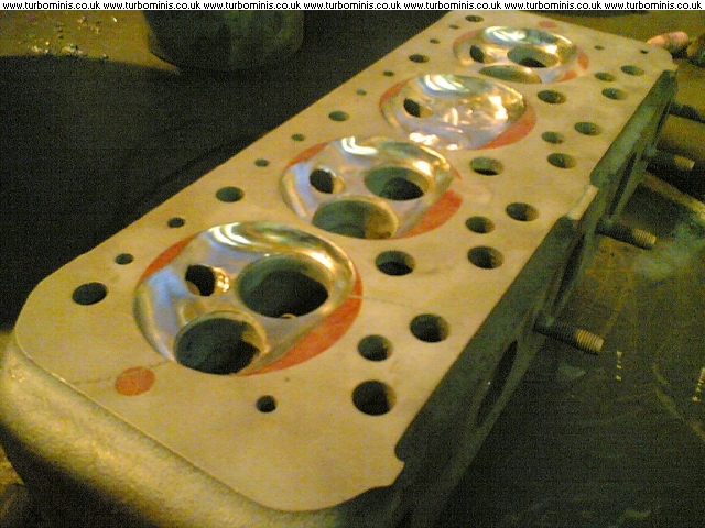

The latest
iain
8506 Posts
Member #: 16
Near Lincoln
have you sandblasted the head?
You had a nice beak in the top picture, why did you remove it..Poor beak, poor squish ;(
