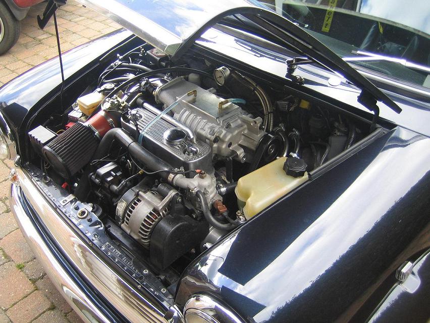

Andy500
869 Posts
Member #: 2443
Cheshire
I did mine like this....
