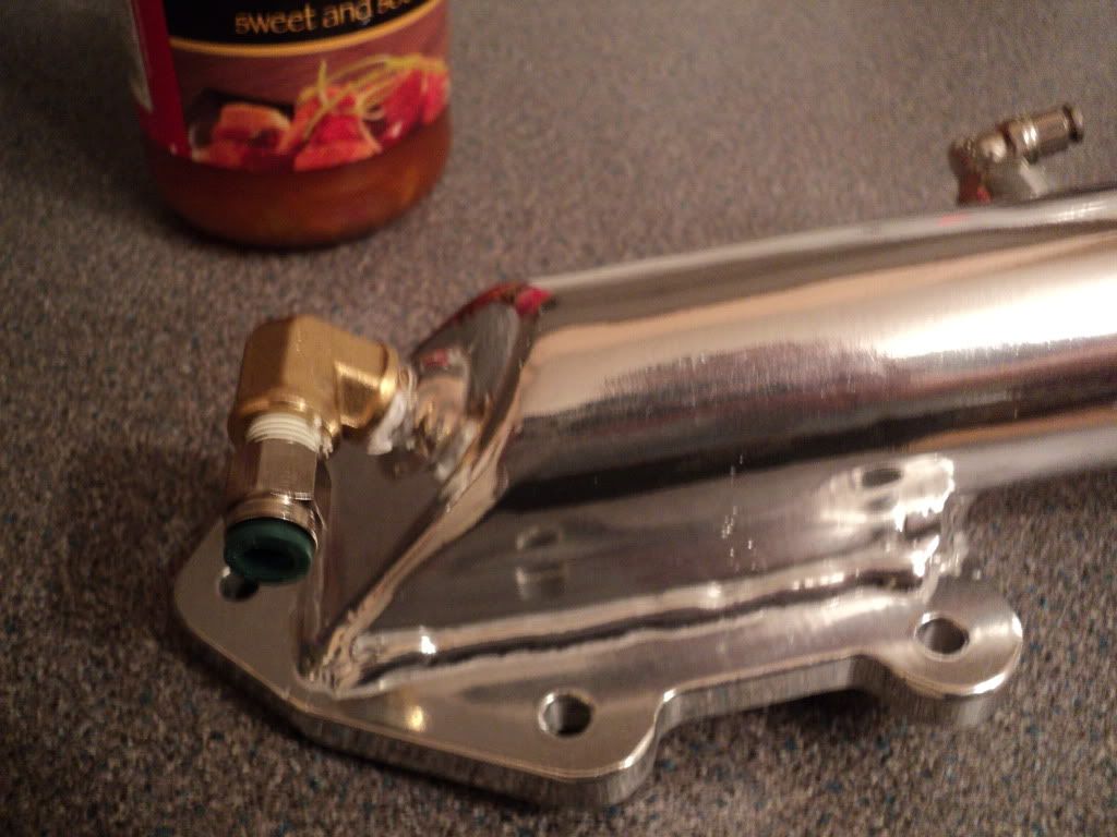

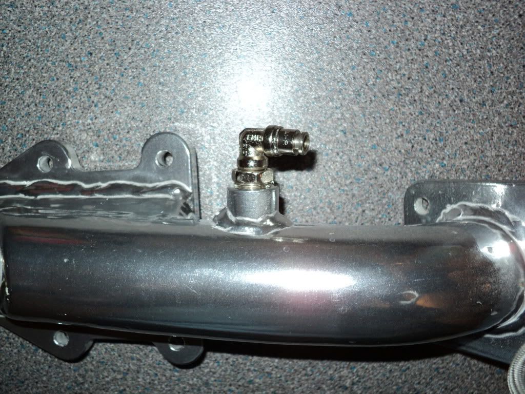

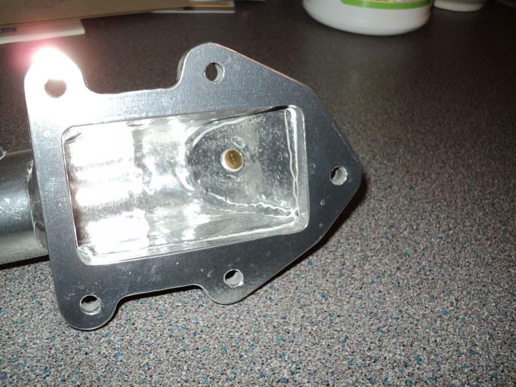

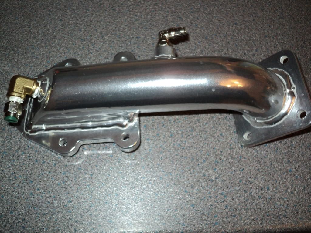

As discussed at Bingley, a pic of the inlet manifold with WI ports and the fitting for the antistall
Shiny
WI port External 1/4 push fit fitting
WI port Internal
Anti-stall port 6mm push fit fitting

This for yours Graham ?
Yep mate, Water injection for 2011...
and I like the idea. :)

Bit more boost as well then ? *happy*

very nice :) thanks for putting the pics up Graham gives me somthing to think about!!
