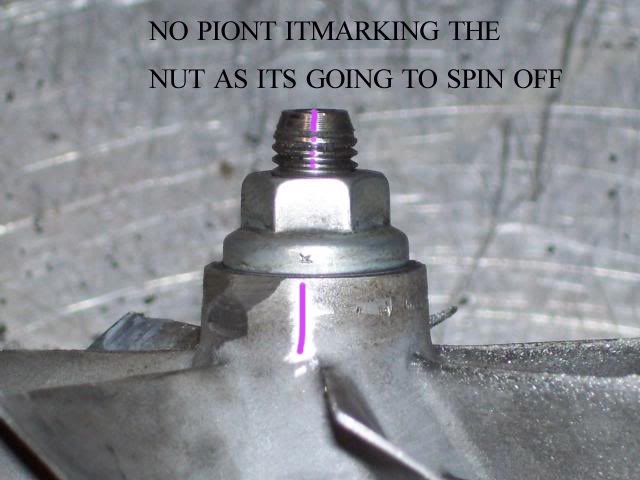

right, i cant copy they photos from the link.
when you take the turbo apart, theres two compressor wheels and a shaft, the shaft is stuck to one of the wheels, so only one comes off, if you look at the link futher down you can see this.
about a third of the way through the link, he says this" ***There is a controversy regarding whether or not to scribe the shaft and compressor wheel to mark alignment. Most of the time these turbos are component-balanced so their orientation during assembly isn't crucial. If the shaft and wheel are already scribed, you'll know the turbine shaft and wheel have been balanced as an assembly. If it makes you feel better to scribe your shaft and wheel, by all means do so.*** "
the photos top and bottom of that, is what your looking for. the wheel thats comming off needs to be marked and at the same time, the shaft, do this before un-doing the nut.
so when you put it back together, its in the same place. Im not the best at trying to explane this. try youtube , im sure there might be a vid or something, just to explane what gets balanced.

wintersurferuk
825 Posts
Member #: 2208
just dubble cheak im right !!!
dont mess up the thread, mark the top or something,
Edited by wintersurferuk on 12th Feb, 2011.
wintersurferuk
825 Posts
Member #: 2208
Right. You might need to mark the nut. Dont know. What's the harm
