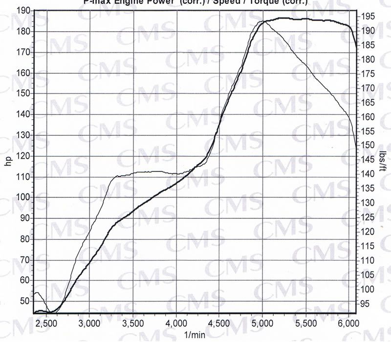

That map is not quite the same spec, but close, you can see the torque tailing off after 5000, that is turbine housing limiting the flow.

Really hits a wall at 5k don't it, what head and cam were being used?
