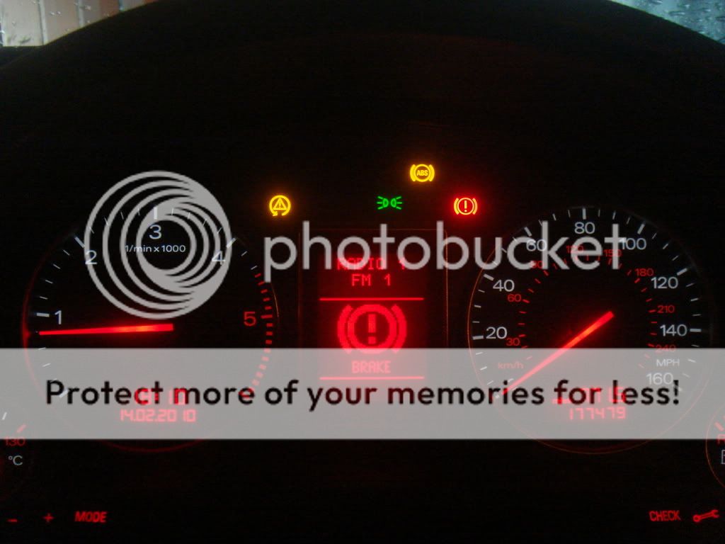

I've not been able to get through to my mechanic this evening and this is doing my head in;
I got into the car tonight after a short stop and when it fired up, the traction control, ABS & brake warning lights all came on and the red brake warning symbol is flashing on the DIS in the centre of the clocks. The owners manual is useless and I can't get to use the VAGCOM until tomorrow. This is the second time its done it in the past few days.
Everything seems to be working ok though - fluid fine, brakes work and nothing is near worn.
As a note, it was in last week to get a new steering rack so the front end will have been partially stripped and the steeling column apparently was partially stripped as well.
any ideas?

all i know is that with audi the abs-pump relais often brakes down....

You don't say what model it is but from what I could find with a quick google search, this problem is quite commonly caused by a broken brake light switch, so check if the brake lights work. The other common cause seems to be a faulty ABS sensor, VAGCOM would tell you that quite quickly. I would suspect it is related to changing the steering rack but I'm not quite sure how.

I had this with the wife’s A3 over Christmas - took it to Audi and there was nothing wrong. So they reset it, its been fine since.
We hadn’t used the car for a few weeks before it happened and the battery had almost drained - it was harder to crank than usual and when it did fire up the dash was like yours.
So i put it down to a power shortage... not saying its the same issue but something to think about - end of the days its brakes so best to get it looked at.
cheers guys - i'm off down to get it checked so will let you know what comes up
just had it on the vagcom - apparently it is a fault with the ABS control unit although it has re-set itself so will just wait and see if it comes back - I hope not though as the units sound pricey!

was it the pump relay ?? coz 9 of 10 times the pump itself is ok.
a repaired ate mark 60 is aboub 150 ex vat down here
