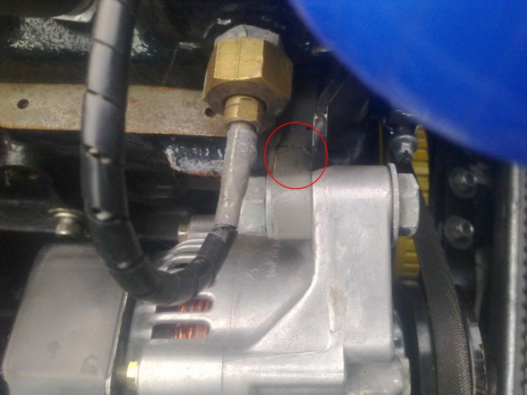

ah... how did yours snap simon? from the nippon? do you think it would be alright with the long bolt and spacer?
Yes it was the alt i think it was the rose joints i was using to push it out and the bottom as there was two much flex in it.

I will NOT be using the rosejoints again! As the alt moves to much with them. When i went back to the old oe one it was fine.
so up to you! but sat on the side of the M25 in the rain was not fun.
