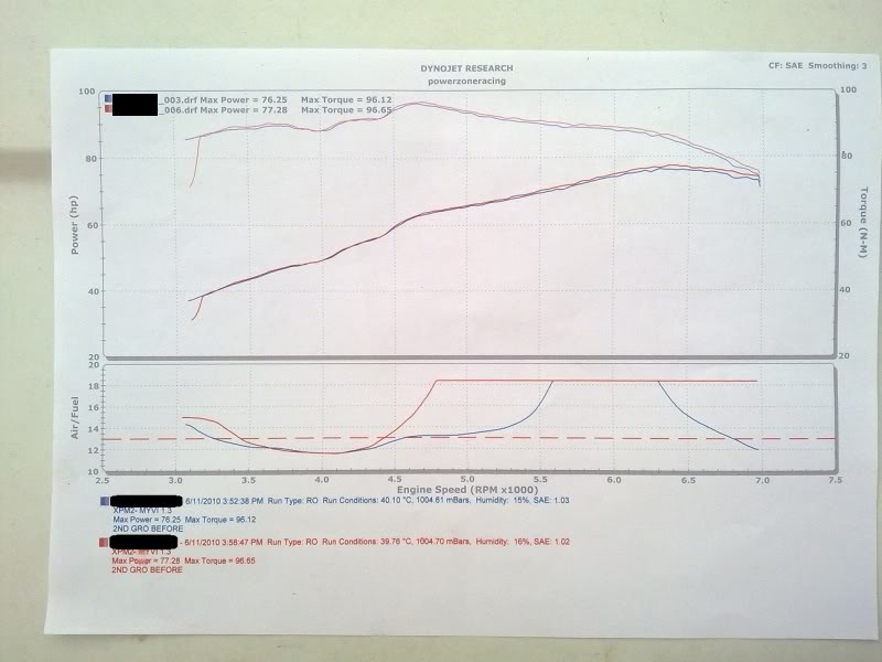

regarding the topic, i have a dyno graph here, showing the power and torque graph of a stock perodua myvi, before and after using a product called 'turbo air booster for N/A engine'
i looked at the AFR graph, but cant understand it. is it running on 18:1 ratio???

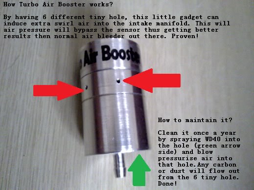

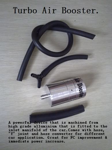

and this is the product.. what do you guys think?

actually its not a fan but more like a booster..i still doubt it as the graph is looking very weird to me...
maybe anyone has the better answer?

not saying this stuff works or not, just curious about the AFR graph.
(the question is originally my question)

It does look like 18:1 !
Whether thats a graph for a forced induction motor I have my doubts.
Any I'm very scepticle of the claims behind this sort of crap.

yes it definitely looking like a forced induction motor graph figure!

just look at the grammar on that picture, surely someone who had the "brains" to make this would be able to put together a proper sentence.
From the graph it looks like it's made fuck all difference other than extend the rev range in which it runs mega lean.

can anyone tell me how to read the graph the correct way and how to understand it..
R.
+1. i dont understand, can a motor even run on 18:1???
it is a graph for NA motor
and yes, beware of snake oil :)
best way to read it would be after 5 bottles of vodka. Then it may make sense.
failing that, dont bother. It's bullshit and their wideband is broken.

it is very lean for a NA motor..
and how does it claims to make more power while the AFR is soo lean??

On 24th Feb, 2011 minimonster said:
yeah i do think so..
because they are trying to sell you a crock of shit. They will tell you anything to convince you to buy it.
