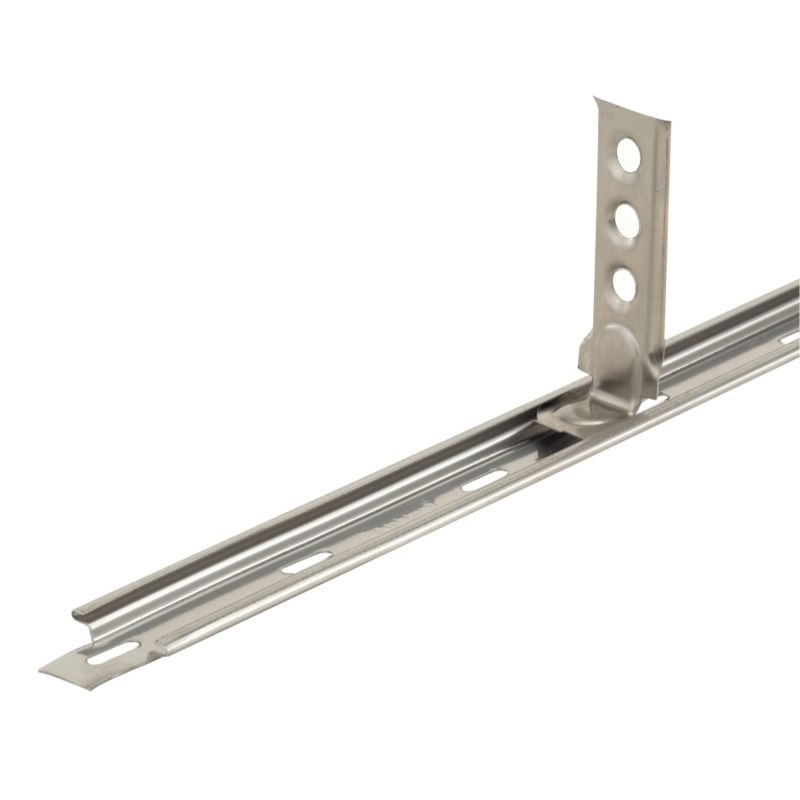

The 2 piece has a slam panel, but ive got hold of some spare starter tie brackets in stainless from work im going to be modifying and using (the little L shaped piece on the rail)
