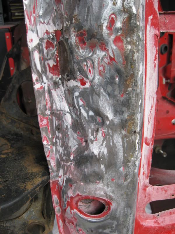

Here is what the panel looks like at the moment. It's hard to tell the condition of it but you can see a lot of dents in it.
Am I better off trying to repair it?

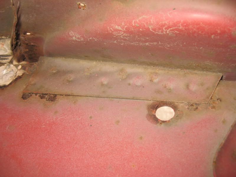

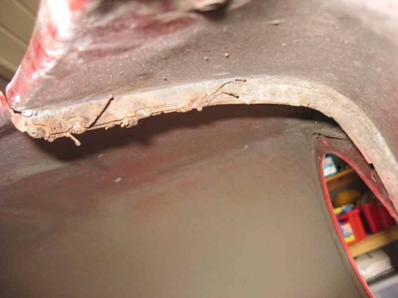

Here is where it attaches to, it looks fairly simple to remove and replace:

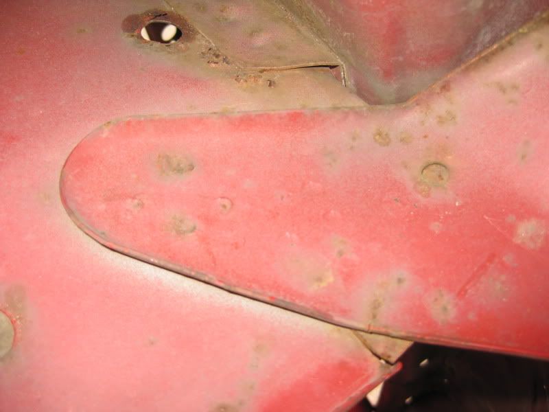

It has already been replaced before by a previous owner and this is what it looks like:

That front panel looks like the original from the spot welds. Either that, or someone has made a very neat job of replacing it. I would say that the weld on the edges is where new wings have been fitted to the existing front panel.
Personally I would spot weld if possible, takes a bit longer to prep, but the actual welding part takes minutes and looks very neat, also very strong if done properly.
Why not fill in your location in your profile, you may find someone local has one you can borrow or hire, I know of at least 3 or 4 people on here that have one.
As Tom says that looks like the original front panel. Its nice to see inner wings that in good condition, it will make your job a lot easier
