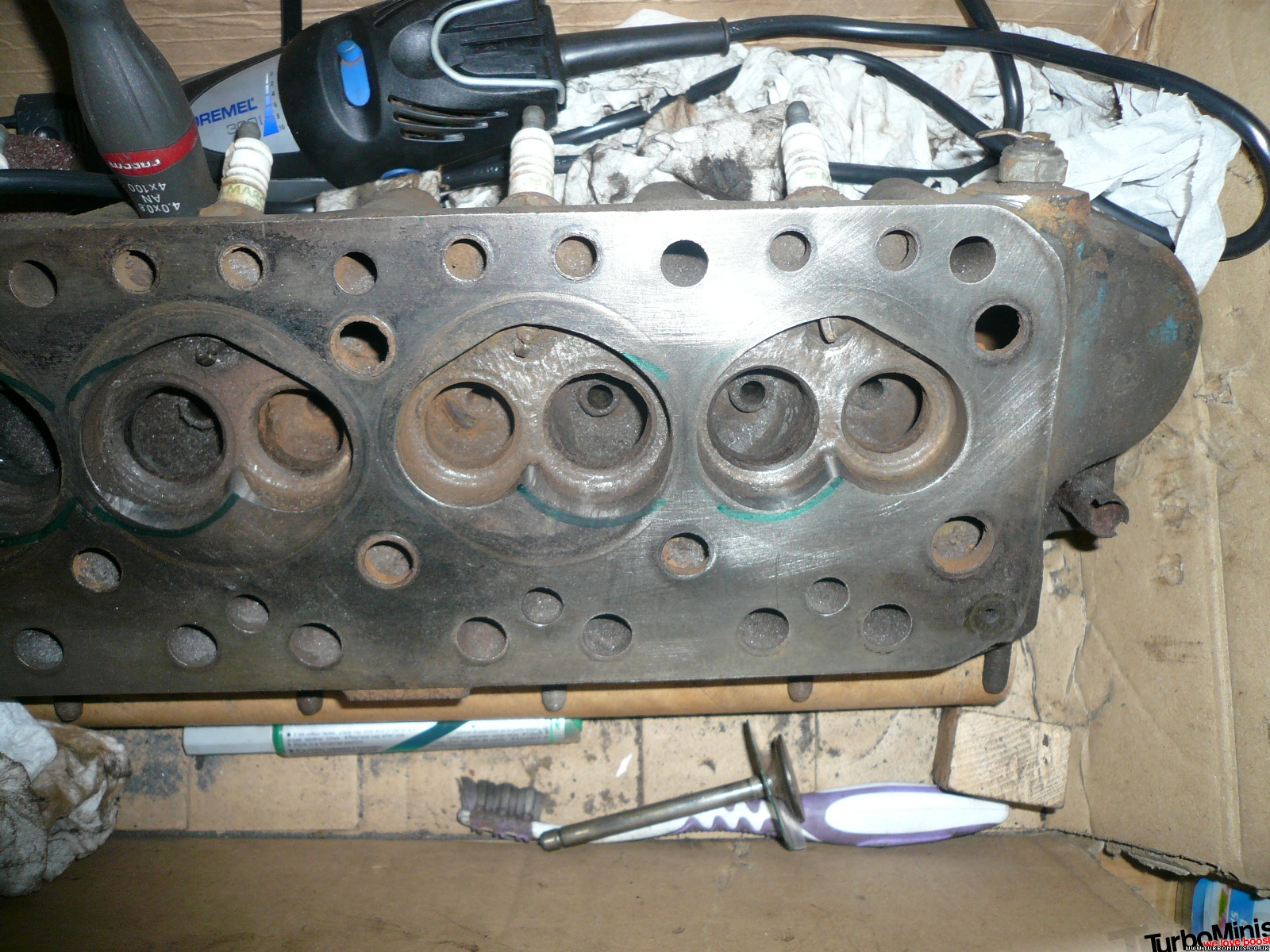

Hi gents,
Edited by Advantage on 2nd Mar, 2011. Rusty by nature

Depending how bad the valve seats are you may find by the time they are recut that the valves sit very low, & in some extreme cases almost falls through, so you may find you need to go up in valve sizes in order to get a decent seat. |
319 Posts Member #: 1742 Senior Member essex |
2nd Mar, 2011 at 08:40:05am
be carefull looking at the exhaust seats most small bore heads i have stripped had burnt-eroded valve seats. If you can get away with just a recut standard valves are cheap oversize ones are quite a jump in price. You could always have hardned seats fitted to runs it happening in the future. This is what i should have done on the 202 i did i just got away with new valves but could do with new seats really which i will do when i next have the head off or prep another head from stock. My small bore turbo project http://www.turbominis.co.uk/forums/index.php?p=vt&tid=473901 |
![]() 7765 Posts Member #: 74 I pick holes in everything.. Chief ancient post excavator |
2nd Mar, 2011 at 09:04:14am
You cannot use std valves at a guess. First of all, they won't clean up the old seat, second they are too small for a performance 998. Minispares 26,5mm ones are perfect, and cheap.

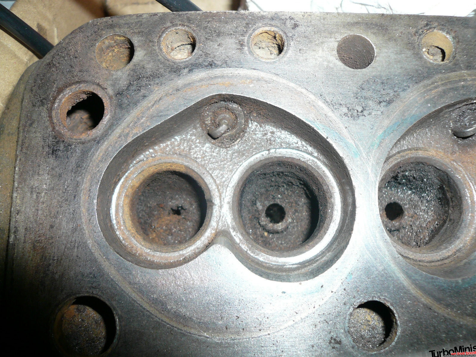

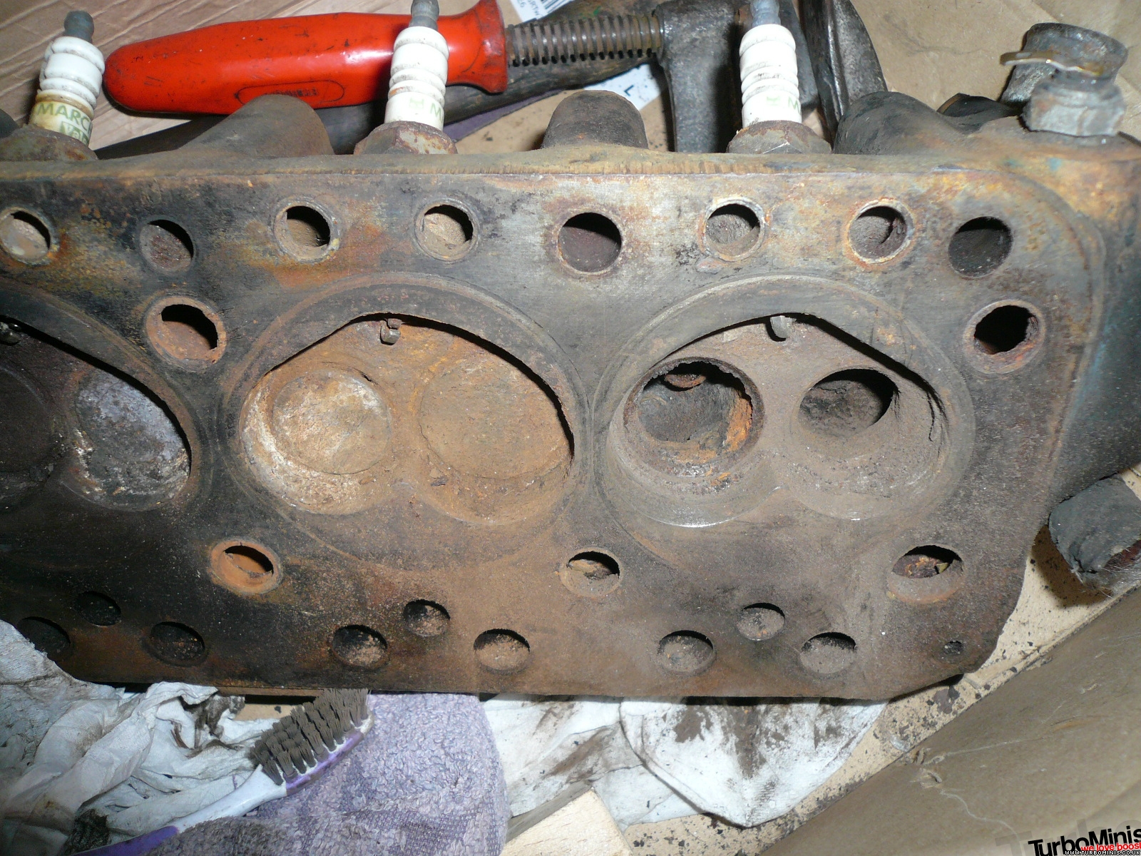

Ho and day 4 pics by the way :

2nd Mar, 2011 at 01:41:14pm
yep sounds like another typical small bore head. If your changing the valves bare in mind the guides might be a different fit on the new ones. Also the guides probably wont have the grove for seals so if too loose you will get the usual puff of smoke. Keep up the good work carefull with the kitchen. My small bore turbo project http://www.turbominis.co.uk/forums/index.php?p=vt&tid=473901 |

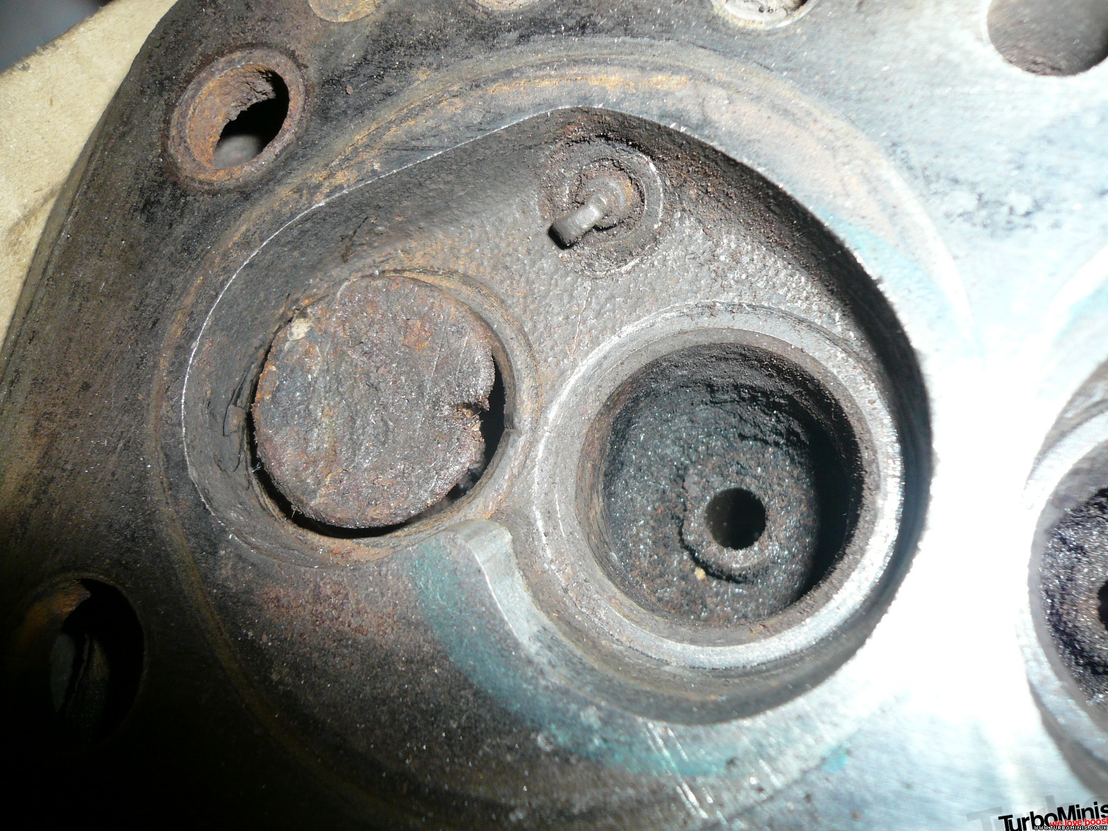

The seat :

2nd Mar, 2011 at 08:43:06pm
On 2nd Mar, 2011 jlay said:
yep sounds like another typical small bore head. It was really really messed up with carbon deposit ! On 2nd Mar, 2011 jlay said:
If your changing the valves bare in mind the guides might be a different fit on the new ones. You're saying that what is tight might become too tight or loose with a new valve ? I have a set of bronze guide, I'll see if they are needed. On 2nd Mar, 2011 jlay said:
Also the guides probably wont have the grove for seals so if too loose you will get the usual puff of smoke. Yes but I am not too concerned about that as this head is really a temporary mesure, on a very occasionnal car and on a tight budget Anybody got a Neway cutting tool ? I cant figure out what size to buy and which can perform a 3 angles cut. Comments on standart 1 5/16 inlet and 1,043" OS exhaust (on a 998 with a MD256 and a set of 1275 pressed steel rockers) ? Rusty by nature
