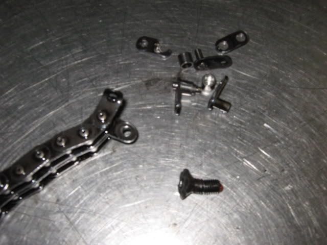

In the workshop by 6.30 this morning and got the timing cover off - correct diagnosis -broken chain.
The culprit -me is the short answer, as one of the countersunk screws behind the crank sprocket had come loose and eventually tangled with the chain.
Got the screw out, as you can see, and was beginning to think that maybe just a new chain as the sprockets look OK.Cover is completely unmarked !!
Engine turns freely but when I same to turn the cam to align the dots before removing the cam sprocket it jammed.
Bent cam ? Bent pushrods ?
Cant get the head off without taking the engine out (bad design, I know) so its engine out, maybe later this morning, and have a proper look then.
Yes Robert it is turning into a saga and its not reflecting very well on my engine building ability. I,ve put together dozens of A series and never had these sort of probs so I must be getting senile, I guess.

Well Colin, thanks to the dish on your pistons and the standard valves, it seems they missed each other !
Just got in from taking the engine out and removing the head. Cam now turns freely, so I must have just felt the spring pressure from a valve and was not prepared to force anything, given the circumstances.
Ordered new timing gear, head gasket etc from Minispares a moment ago and looks like I,ll be putting the engine back in next week. Bit fed up of this in and out business -four times in the last three weeks.
