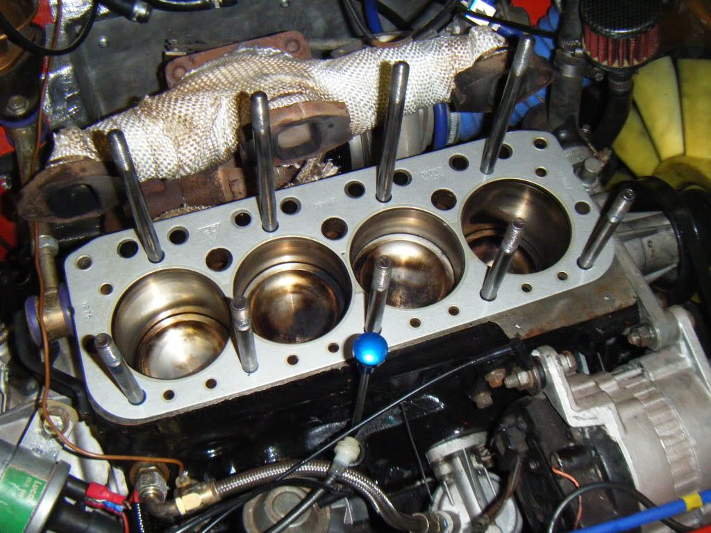

Yep that's me. Started turning the boost up and blown the head gasket. Well at least i hope its the gasket.
oh dear. post some post mortem pic's

Will do. I'll start stripping it tonight after I've put my kids to bed.

Here was the problem
oops.

That's well fubard.
What CR, boost and advance were you running there matey out of interest ?

you wer lucky. pre ignition sorted that for you. if you dont sort it, ie lowering th CR or intercooling it and or ignition advance, the next time will be the pistons melted

Blimey thats pretty extreme, check the block surface very very carefully before you consider putting it back together.
10022 Posts
^agreed they tend to sink between 2-3
That big burn is between 1 & 2.

Block and head are fine, and are still flat with no high or low spots.
When it popped I heard the engine note change and shut it down straight away so no further damage could be done.
The compression ratio is (just used a cr calulator) 7.59:1, Ignition and fueling was set up by a guy on the rolling road and the boost was 15psi+++, as my gauge run out of numbers. *happy*

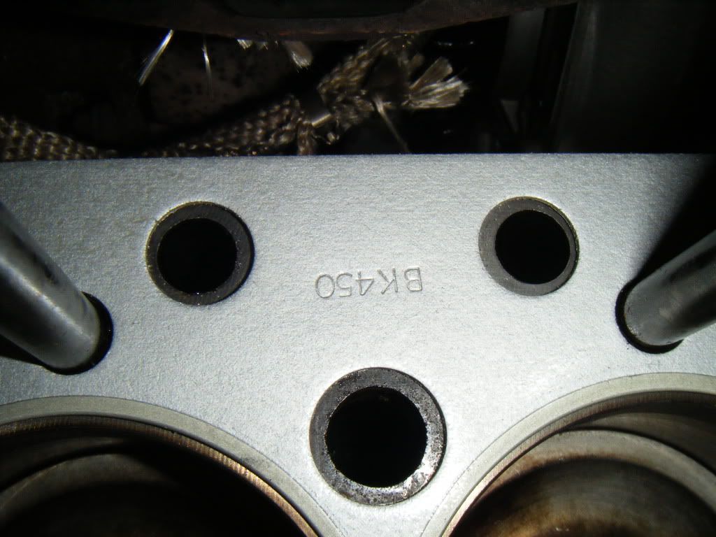

Gents I have a spare gasket in my garage with bk450 stamped on it except it is grey in colour. I've only ever seen black ones.
Whats the deal with this then???

All fixed today and back together. Did a cool and hot compression check and equal across all cylinders. Hopefully I won't have anymore problems for a while. Fingers crossed. *Clapping*

Are you sure that is pre ignition?? Looks like mice have been in there!!!
Is that gasket made by Payern?

Don't know what the make of gasket is. It's got the CP in a triangle and 'made in England' stamped into it.
The gasket was in a complete gasket set I bought a while ago branded 'Ultra Parts'.
