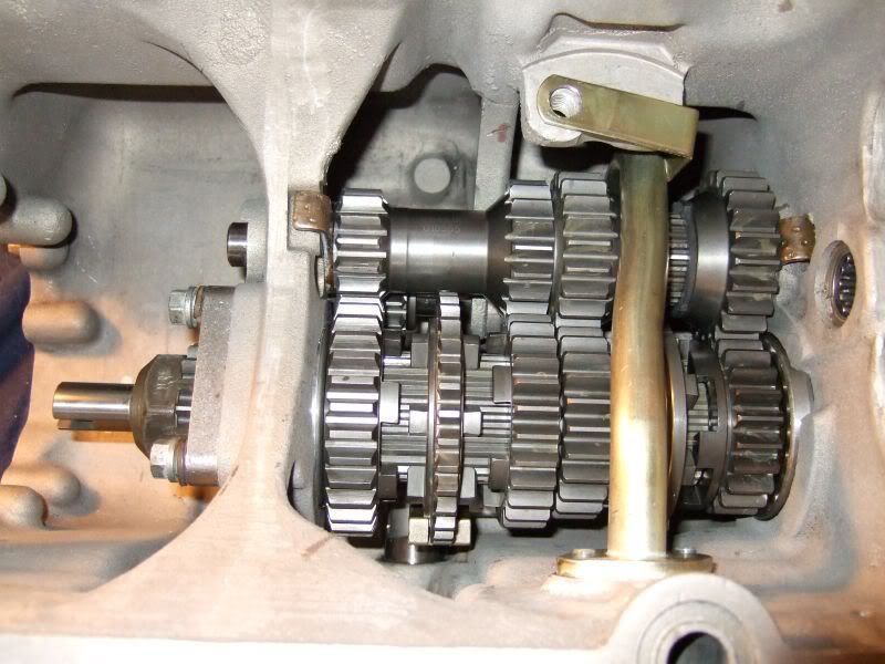

Have you seen this? Look at the size of the gears.

Wow, at last. Shame, probabably gonna be way too pricey for most peeps

are they that much bigger than in a swifty box for example?
The dogs look rather small though.
They don't look much bigger, no, but bigger is bigger.

Yes. Very nice item it is! I am unsure if the dogs will be a problem being that small for a turbo engine? Is it normally the gears themselves which represent the problem really?
They say its good for 200hp, lol, that is so 2005 *hehe!*
Pfft. All that work and they didn't stress relieve the casing!
things to note are the pinion is part of the mainshaft, so no problems with it breaking between the base of the tooth and the spline which would hold it on in a std mainshaft
i like this bit + the size of the gears but not the size of the dogs, i still think the case is the weak part though*happy*
3rd gear is still not very well supported but it might help it last a bit longer in Matts car

Looks good though. They just need to design a centre web support or some sort of brace for the casing.

what would that come too to buy ? any one no
1293 Turbo mini
About £6k
and the rest
£6k iswhat it cost for the JKD 6 speed way back then

Didn't that use a custom casing?

And i can't see why they didn't tidy up the casing like the swifty box. Seems dumb after all the work done.

Does anyone make an uprated casing nowadays or is that unheard of?
