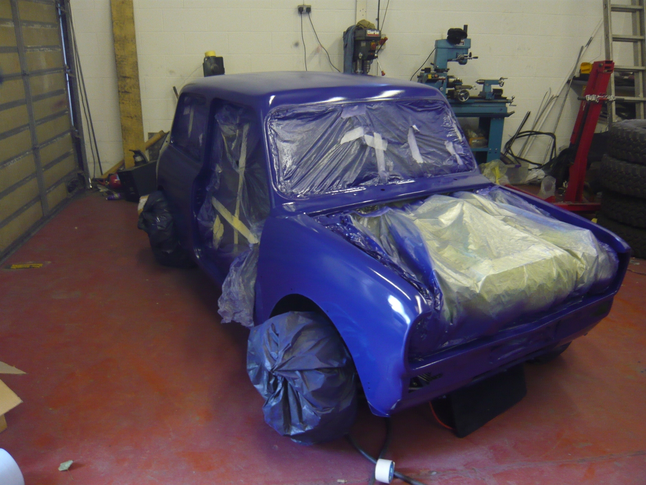

Finally got some paint on it.. first coat, and not flat yet.. but the colour is almost exactly what I was after.
