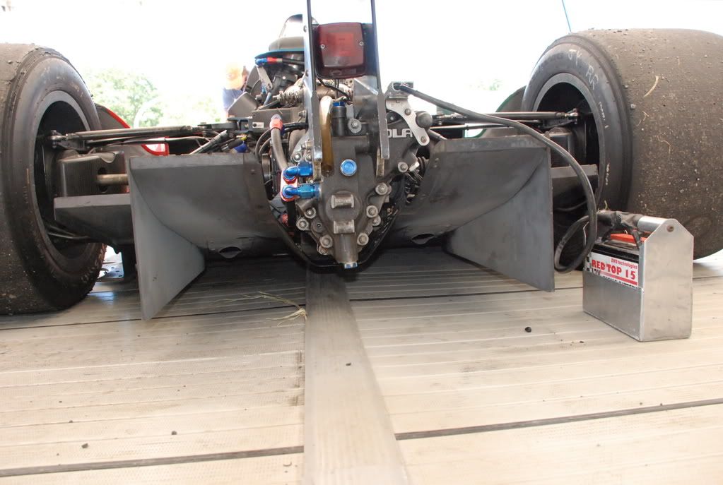

however I have been hearing about exhausts ducted into difusers to enhance airodynamics/downforce.
yup , had one on mine last avon . *Idea*

That must help Joe, especially on a naturally aspirated engine, sucking those spent fumes out as soon as the valves open?
My initial thought was that the exhaust flow would be to much, either there would be no effect or it would destroy the downforce effect,
...but it looks like exhausts do exit right at the point of most depression, so it could work, you might need to be going very fast though!
Looks like a good idea on things like f1 cars, but on a mini youre trying to apply aerodynamics to what is effectively a breezeblock in terms of cutting through the air. Ill stick with my rc40 *happy*
What F1 are currently doing is using the exhaust 'power' to improve downforce, rather than use aero to improve exhaust exit.
Put it this way, McLaren couldn't get it to work, so it's unlikely any of us will find any benefit.
