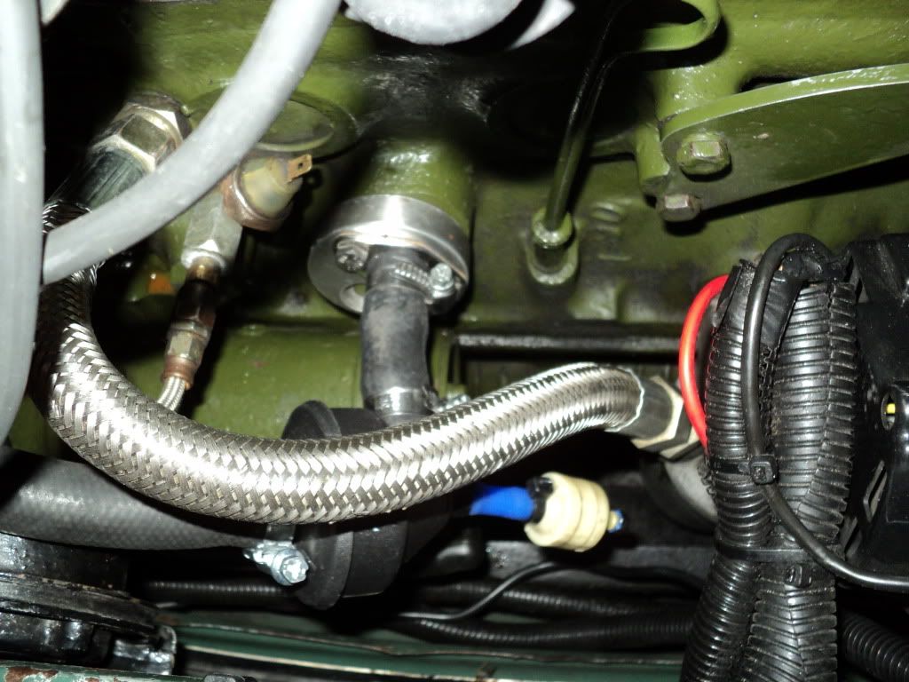

well after drilling three holes, tapping two, one heater take-off, some pipe, and clips I ended up with this.... I used the ford filler/breather cap just made the 90 deg easier.. Hopefully it will help..

I copied this idea, Im using the rocker box to catch any oil, which then vents out through the other blue pipe, hopefully it will help crankcase pressure.
