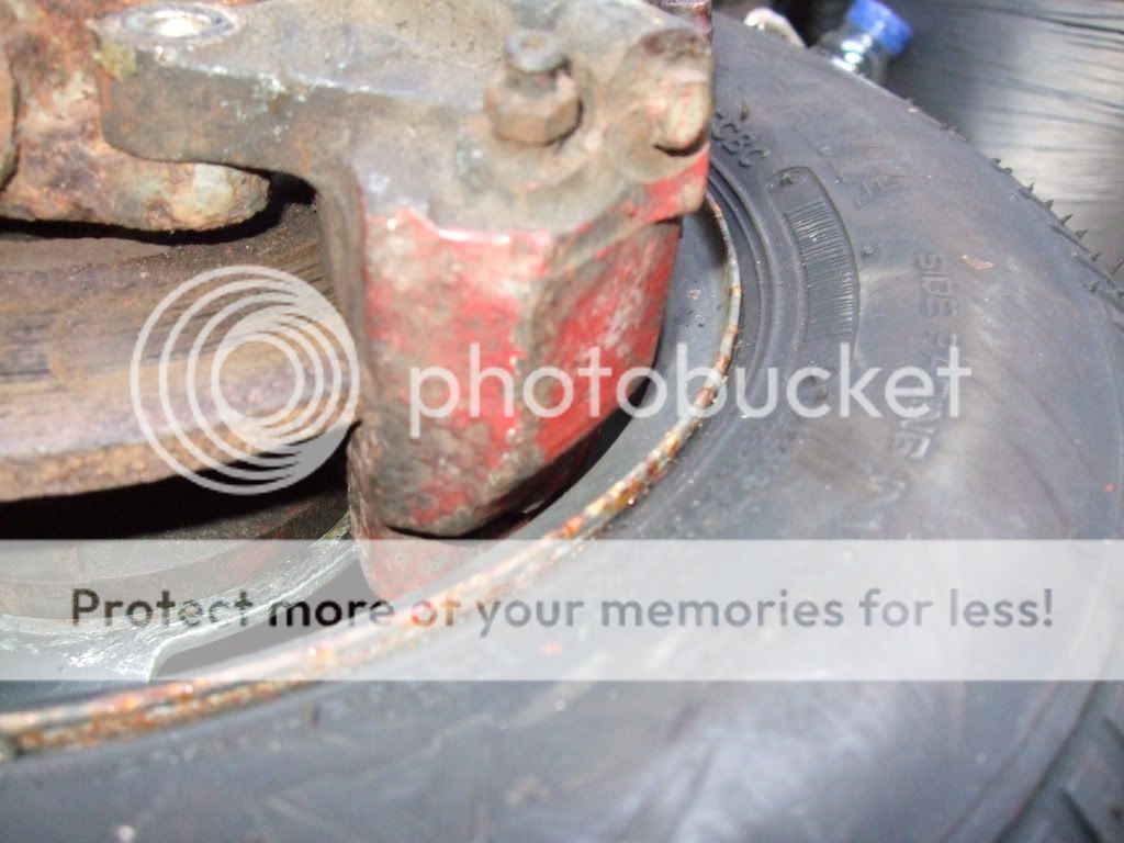

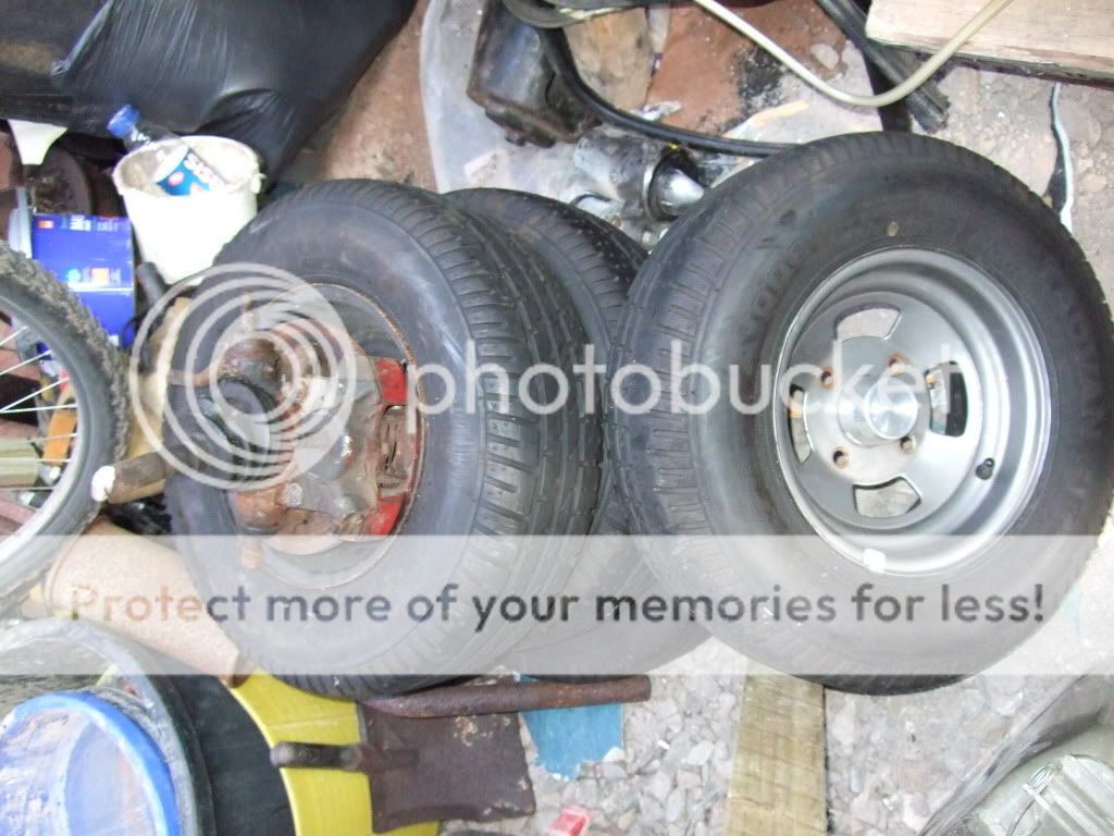

http://i822.photobucket.com/albums/zz144/tomgale09/841.jpg
http://i822.photobucket.com/albums/zz144/tomgale09/840.jpg
Stupid ET n such..........
[X] nail here for new monitor
I'll bet that handles like a greased pig on roller skates.
