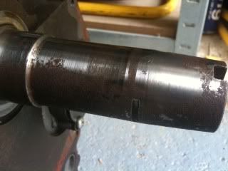

I'm thinking leaving it for 2 years in a bin bag was a stupid idea!
Can anything be done with that amount of corrosion??
Thanks again...
Shaft seems nice and snug
That will probably polish up with some emery cloth.
Always oil them up before storage though.

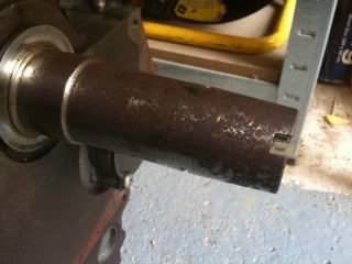

Really? I was worried it would have too much metal missing to use again if attacked with emery
Re bush the primary gear and machine it to tollerence on the crank. Job done *happy*
As above really. Once the taper is clean, lap the flywheel on with some grinding paste.
almichie
824 Posts
Member #: 2065
I've polished the rusty bit as best I could...
There is some pitting on the surface still.
Will this be ok to use like that??
Yeah, as long as the mains and big ends arnt the same, which they wont be if it has been in thet block the whole time.
