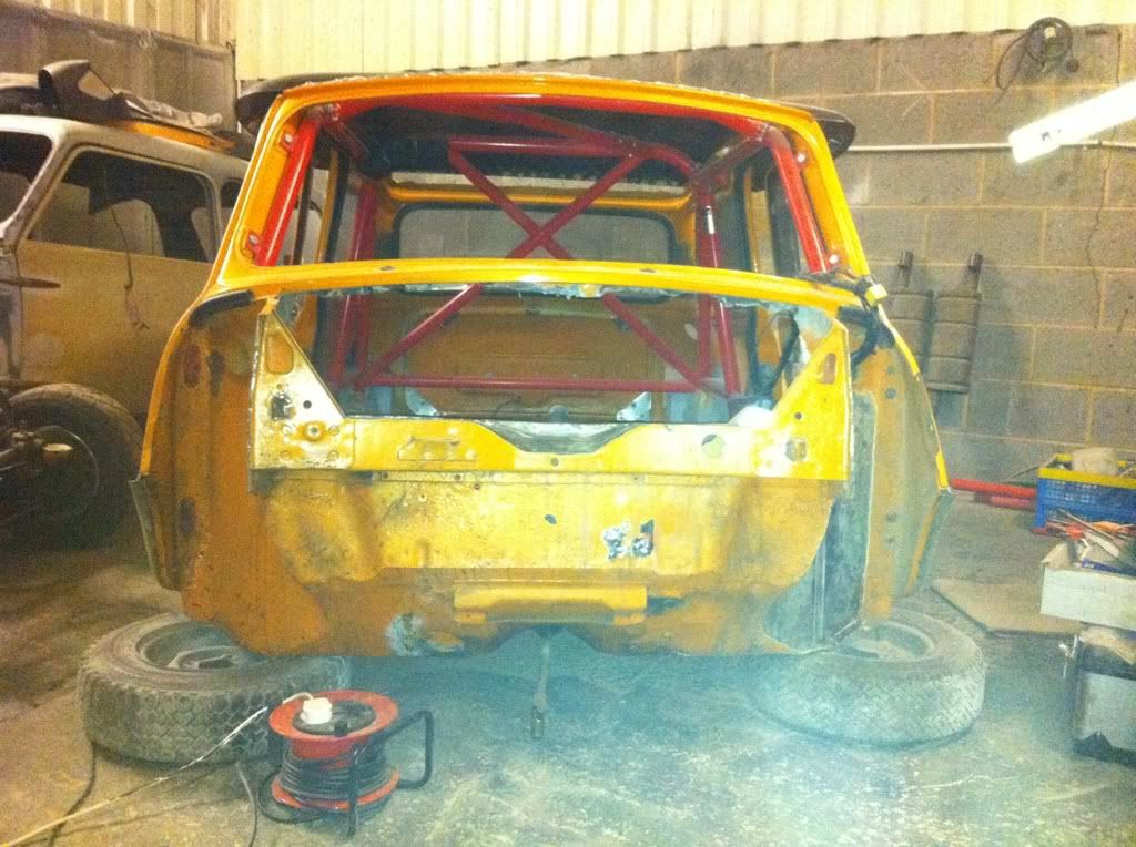

have you got any pictures of it rich?

The only one I have on my phone is this
Hope that helps

that does look good rich. bet its heavy though?
is that a harness bar running along the back seat? or is it a bit to low?

It's not too bad, think in total with plates and bolts its 38kg. It's a harness bar in the back and from the front legs it's triangulated to the bulkhead.
