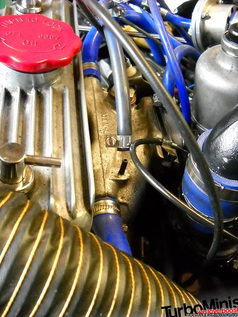

i was wondering if the pipe i take the vacuum and boost from could be to small?
I blew a headgasket and found that my wastegate could not move freely. I fixed that:)
But when i was checking the waste gate when the engine was running i did not see any movement.
When i disconnected the hose from the manifold and blew some air in the hose the waste gate did move.
To make sure i plumed a extra gauge into the lines and when it's getting it's signal from the manifold nothing is happening, no boost to be seen on the gauge exept that the dump valve is working. So there is some boost but i can't see it on the gauge.
When i blew some air in the hose myself it was showing that on the gauge.
So does the point where you get put youre wastegate, dumpvalve and boostmeter have to be a certain size to work properly? Ans what size is the minimal*happy*
This how i have it at the moment......

you'll need to connect that pipe for it to work! *hehe!*
try blowing down that take of to make sure its clear,
also suck on the pip your connecting to it to make sure the gauge moves.

Well the foolowing things i checked so far.
1: i removed the dump valve, when i rev the engine i can feel air blowing out off the plenium
2: when i disconnect the hose that goes to the actuator i feel it having a vacuum. even if i rev the engine.
i never get boost as i get in the plenium. But the butterfly will blocking some
and the pistons are sucking a lot off air inside. But i must get some boost to get the actuator working?
When you drive the car it's fast but i never see the actuator opening when i rev it by hand.
What is going on? I don't want to blow a other headgasket*tongue*
