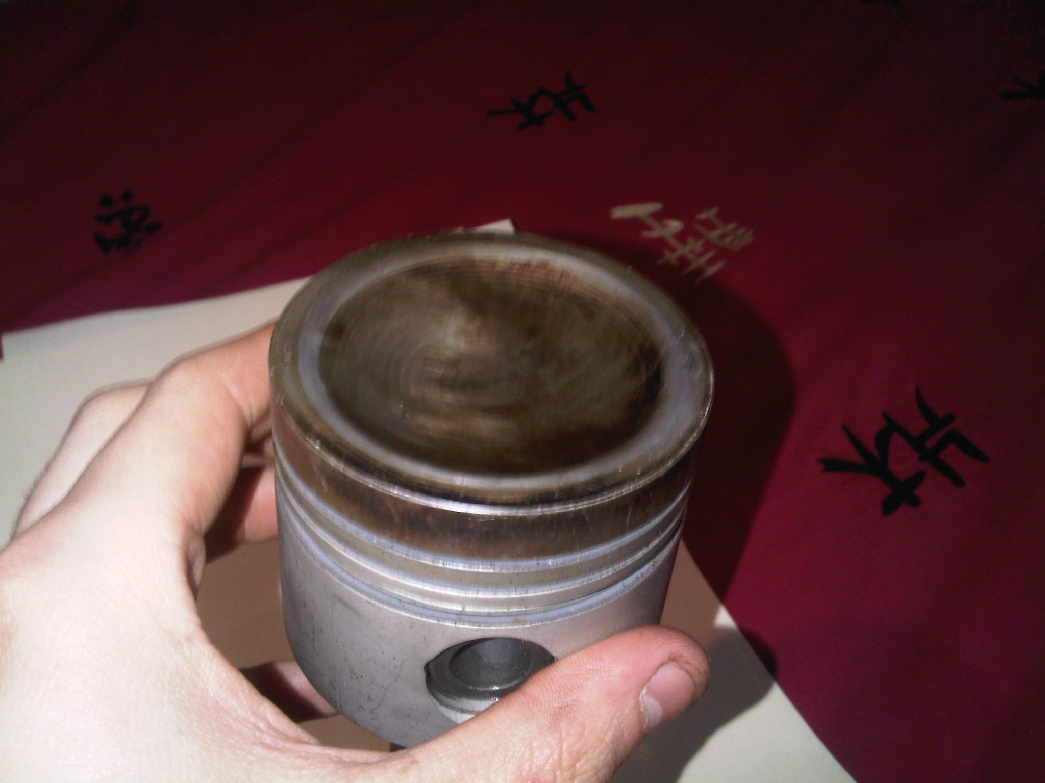

this is one ive grabbed out of my garage if you can see the dish
4309 Posts
Get a syringe and a piece of perspex, drill a hole in the prespex and a small vent hole, stick the perspex over the dish, fill with liquid and note how much was in there. From memory the minispares pistons are 9cc though I'd check that.
Just trying to ID the pistons in my engine too. They have the same number as above but as stated, they have a larger dish. This is a standard looking dish, not additionally machined.
Anyone get any further with ID?
