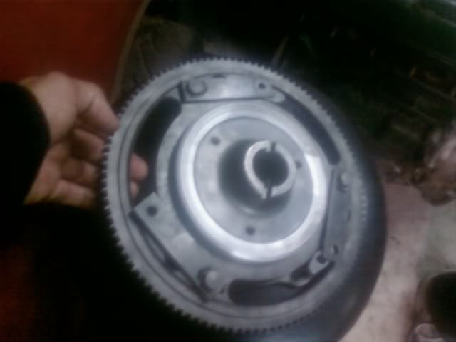

we havnt had any problems with the good old std issue grey on "pre-verto' light flywheels & steel back-plates, but anything over about 140-150hp we machine the flywheel & make a ring press fit onto the flywheel to move the pivot point for the spring on the flywheel, this way we can get 1200 or 1400lbs of pressure using a Blue,,, yes just using a blue. this keeps peddle pressure down also, but you do loose a small amount of travel. not a problem tho
using this technique i expect you would be able to get Stoopid clamping force with a grey *smiley* if you needed more than 1200-1400lbs clamp that is
one of the problems using thin lightweight flywheels & back-plates is the flex,,, once a bit of flex sets in then you loose some of the clamping area, so we try not to make them too thin, keep some integrity in the flywheel & back=plates & all should be well
Can you explain it in more detail as the pictures are a bit blurry
I'm very close to buying and building my engine, but would like to use pre verto for the weight saving, but I'm concerned about the heavy pedal and thrust issue with using a grey plate
Was looking at the RTS, but there is no simple instructions on what to do
I'm very interested in your idea

10022 Posts
Looks quite clever that Matt.
I'd like some more info on the preverto mods too Matt, I can't work out whats going on there.

MadMatt
703 Posts
Member #: 105
Brisbane ,Australia
well, simply put, the pivot point for the spring is moved outward, a steel ring is machined & the flywheel is machined to have the new ring pressed onto it, & now the spring is instantly produces way way tougher clamp pressure.
i havn`t used a grey with this set-up because we havn`t had to (Yet) the blue makes enough grab, in fact more than a std grey does, but i expect the turbo-twinky that i`m working on currently may need a grey *smiley*
we`ve done this mode for some serious race mini here in Aus for hundreds of millions of years *smiley* & all work a treat,,, Stewy has one in his 1600cc, Arden cross-flow 6-speed sports sedan with 145hp & no dramas
the only issue is they use less travel to diss-engage, but who gives a shit about that ? *wink* *smiley* *smiley*
