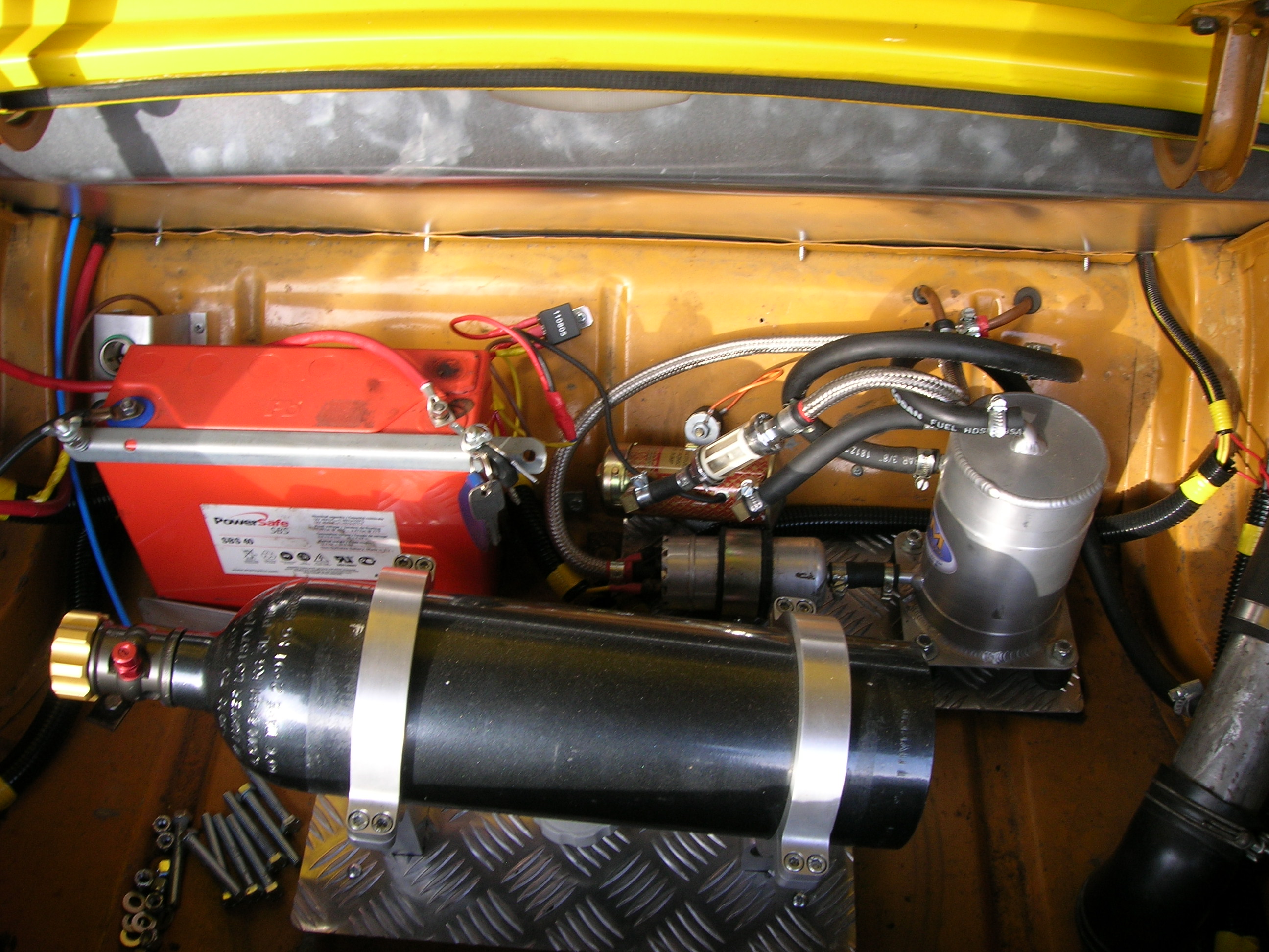

David,the loctite was on the valve body threads,maybe co-incidence but it seals (so far!)
My swirl pot set up looks like this

I prefer the NOS tank to the swirl pot !
Your swirl pot seems to be identical to my oil catch tank
