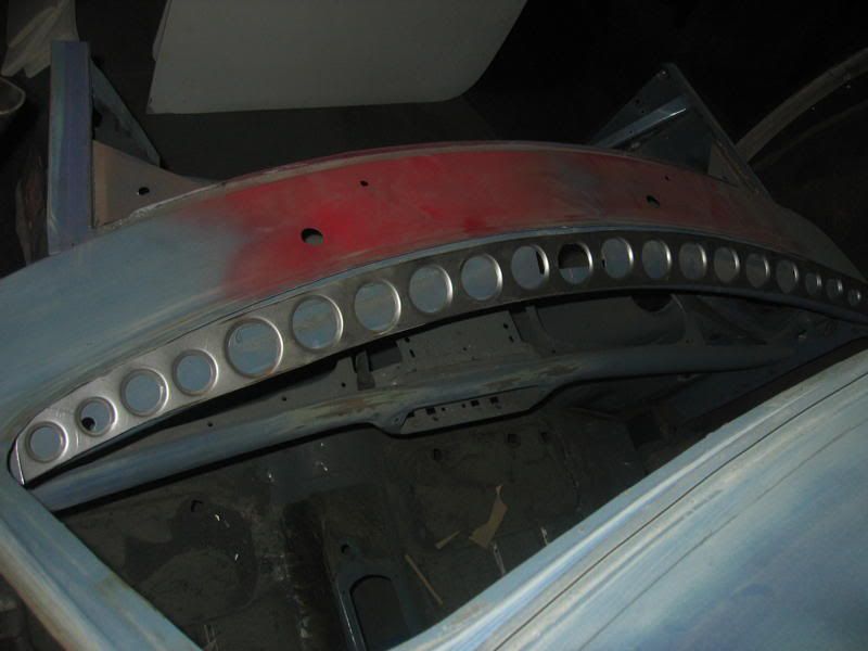

Can you do this safely at any point?? I have thought of a few places and the car will have a cage and bracings

The top, i wouldnt have thought so.
The bottom, put in a dash bar and loose the bottom one.
OMG Robert that's a big one

i've seen a pic somewhere of a top dash rail with swaged holes in it, but i cant find the pic anywhere!
edit: found it
Edited by jamestar on 9th Jun, 2011.
I'm going to put a few swaged holes in my top rail, but nothing as drastic as that
I was only going to do 4-6 just need a swager for it
swagers - plural, it's deeper in the middle than at the sides....
edit: found it
correct me if im wrong but this isnt the top dash rail thats been swaged

I was thinking about swaging holes, should be able to take a bit out the lower rail aswell and it looks quite smart

The only thing is as im going to have a proper dash it dont be seen, it was food for thought and mr penicaty its only a for of hole *tongue*
edit: found it
You are right, that looks like a bit of (badly) swaged trim. So more weight! Odd selection of hole sizes.
